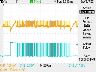

I used full step regime, reference value Vref=0.48V (Rsen=0.2 Ohm for this EVM), 1000 PPS, Vm=9V. Other parameters
were in the default state.
But when I switched up the motor it sounds very noisy and warms up!
I connected oscilloscope to the output pins of the EVM and see very strange (for my opinion) picture - the base
signal from B-,B+,A-,A+ was modulated by high frequency pulses (near 31 kHz like switching ITRIP frequency).
Moreover the value of the amplitude of the output signal was 9V, but I hope i would be near 4V (as my motor need). I
tested IsenA, IsenB output and saw that voltage on sense resistors is modulated too.
What can it be? How should I use this IC to control my step motor without this modulation?

CH1=IsenA, CH2=Aout1

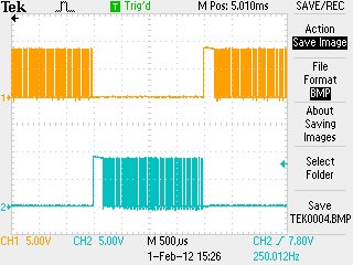

CH1=Aout1, CH2=Aout2

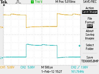

I can increase Vref to stop current control, Vref=1.72 V. Modulation disappeared, but in this case my motor will burn! Below I attach picture with Vref=1.72V

  • Hi Kozlov,
    What you are observing is what you should be observing. The DRV8825 is a current chopper bipolar stepper motor driver and it is based on the idea that we can PWM the input voltage to obtain a lower voltage (the voltage your motor needs) and at the same time regulate the current to a safe level. I recently posted a blog article depicting this confusing matter, here: http://e2e.ti.com/group/motor/b/blog/archive/2012/01/17/the-5-2v-stepper-motor-and-50v-stepper-driver-paradox.aspx
    That being said, even with current chopping, the motor will get warm. This is just part of the game of driving a stepper. Ideally you do not get it too hot, as that could cause damage but if your output current is below or at the motor's rated current, you are in good shape. Believe it or not, if the motor is driving a load, the motor will get less hot. This is because when there is no load, the great majority of the energy being put into the motor will be transformed into heat. When there is a load, however, most of the energy put into the motor is transformed into kinetic energy and the rest is heat. Of course we are dealing with a non ideal system, so transforming all the electrical energy (P=IV) into mechanical energy (P=wT, where w is the angular velocity and T is the torque) is just not possible.

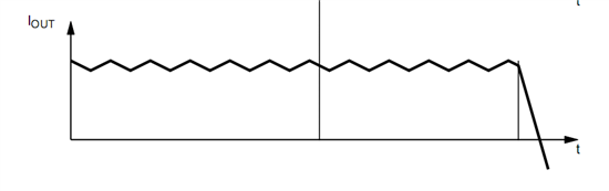

    But the main question was not in why the stepper motor is warm, but why I see 100% amplitude modulation of current. I expected something like
    But now I understand that in PWM concept it's impossible if I have high different between Vm_stepper_motor and Vm.

    Glad I was able to help. The graph that you show is what you will see with the DRV8825 and your stepper motor if you look at the winding current with a current probe. The captures that you sent on the first post were for the output voltage and the SENSE voltage. Both of this will look like a PWM because in essence that's what they are. Except that we close the loop by modulating the PWM duty cycle according to the desired current and the measured current on the SENSE pin.
