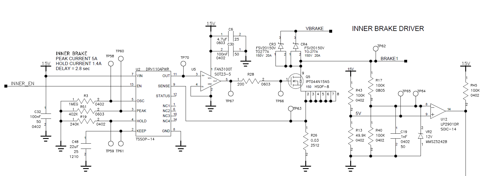

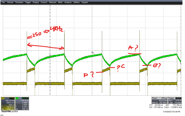

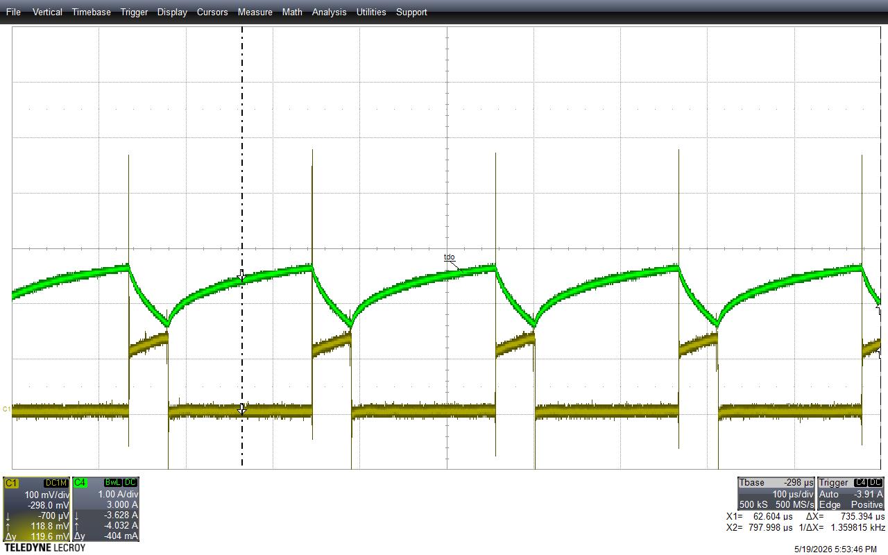

I'm driving a brake module which acts much like a solenoid...  The circuit operates from 24VDC to 80VDC but the DRV110 Vin is provided by a 15V regulator...  The circuits works as expected until the voltage is between 57V and 80V...  At that voltage the DRV110 becomes unstable and appears to be ringing...  I've attached the waveform for 56V and the one at 57V for comparison...  Note the green trace is current at the brake, the yellow is the voltage at the current sensing resistor...   The current is upside down...

    From schematic, Ipeak: 5A, Ihold: 1.4A, fPWM: 4kHz, keep: 2.2 sec
    1- Could you please clarify which test is at 56V and whihc one at 57V?
    2- How is the current measured? it seems that the current prob direction is toward supply not to the load.
    3- Test A shows higher frequency? the expected frequency is 4kHz. what are the conditions for Test-A? Also the current max, min, and mean is not clear. please measure them.
    4- Did you measure the current during hold or peak condition?
    5- Also can you measure Vout as well along with current and Vsense.
    6- Vsense looks noisy too. What are the Vsense ( min and max (C&D))?

    The circuit operates properly at 56V and below , this is the scope trace that's operating at 4kHz and has a PWM switching waveform with an approx. 20% duty cycle...  Above 56V the DRV110 seems to oscillate with a very small duty cycle and high freq and appears to be ringing...

    One side of the brake coil is connected directly to the power supply... The drive circuit is connected to the other side of the brake coil... This design is a low side driver...  The current is measured on the high side of the brake using a current probe...  The pulsed waveform is measured at the current sense resistor...
    Sorry, apparently, I didn't capture the ground ref for the current waveform in green...  The current probe was clamped on the wire backwards, so the current waveform is upside down...  But the current measurement is indicated in the green block in the lefthand corner of the pic...
    Yes, the current peak is set to 9A and the hold to 2.4A...  I've pics for peak and hold currents below 56V but only hold current above 56V...  I can provide more pics...

    The Rsense value is 0.03 ohms...  You can see the Vsense measurement pulses on the scope outputs I sent...
    Also could you please let me know what are the R and L of the brake motor( solenoid) ?
    I attached a drawing of the brake associated with these waveforms...  The circuit drives two brakes one has the 9A peak the other, not shown, has a 5A peak....  The drawing has most of the electrical information but doesn't list the inductance...  I can measure that for you...

    These two are both at 48V...  The one with varying duty cycle is at initial turn on at 9A peak and the other is the hold current at 2.4A
    It is confusing. From schematic, Ipeak: 5A, Ihold: 1.4A, fPWM: 4kHz, keep: 2.2 sec.
    The 9A and 2.4 A are not matched with the shared data.
