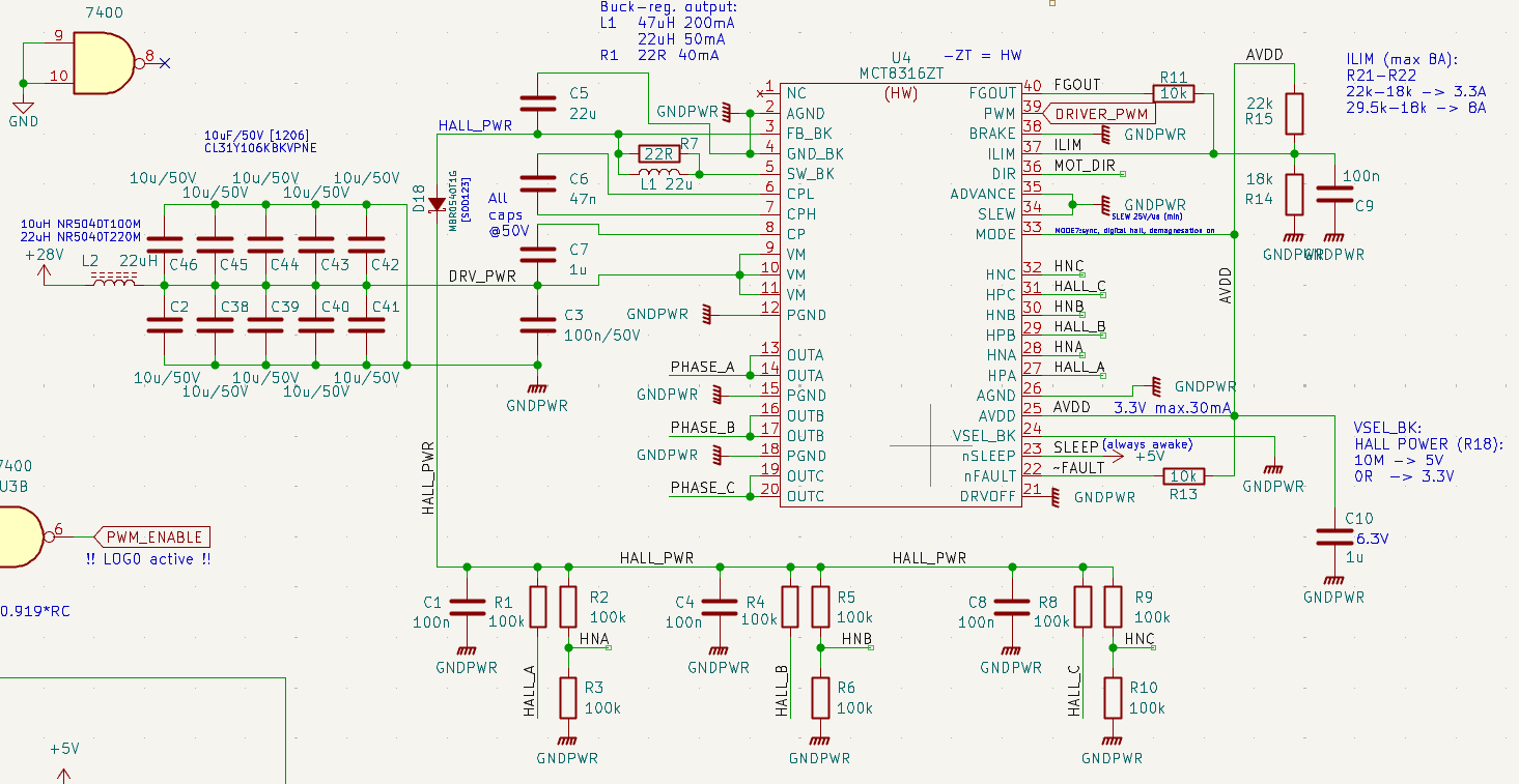

we are again facing a trouble with the "HW" version of the MCT8316Z driver.  Please consider the schema below.
The situation is following: the driver is controlled by discrete 7400-based logic. The driver is set to never sleep, direction signals 0/1 come from the 5V-TTL gates and the PWM signal (either with configured duty cycle 0/25/50/75% or full (100%) as log 1). The PWM signal is purposefully delayed by 1 ms as we noticed (in installment III of these forum posts) that after a direcion change there needs to be a short pause between rising the PWM input. The BLCD motor with three hall sensors (Faulhaber_2250_BX4) is not loaded.
The problem is that after raising the PWM input (pin #39 PWM) to log 1 the motor (in most of the cases) refuses to spin. One can only hear a weak/slight click from the motor. When you help the motor shaft to spin by hand, it starts running just fine. The clicks correspond in time to the FAULT signal being lowered and later on raised (reset) by the pull-up resistor R13.
This means there is some kind of fault. The datasheet gives a list of possible causes for the FAULT signal (p.53-58). This is the "HW" version of the chip so there is no SPI to read out the error register / if there were any in the "HW" version.

  • Hi Josef,
    Thanks for providing the detailed schematics for review.
    The schematics look fine, and the HALL/HNX lines should remain floating.
    The issue appears to be a synchronization problem. In the 1 ms pause, does the motor stop completely? After the motor has stopped, wait for the speed to reach zero, then change the direction and issue a speed command by setting PWM log 1 (or whichever duty cycle is appropriate).
    The fault behavior—500 ms low and a detection time of 1,000 ms—matches the hardware device configuration.

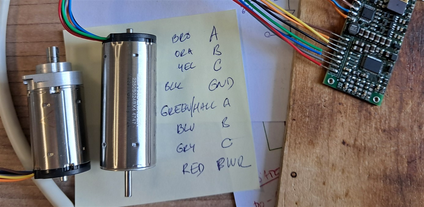

    3. The motor is expected to spin but in most of the cased (9.5 out of 10) it does not. The driver demonstrates the behaviour described in the section 8.3.16.8.2 motor lock with automatic retry. Only after I touch the shaft of the motor (move it a little) it starts spininng.
    After I removed the HNx resistors (they are now floating) and it behaves the same.
    The situation on the desk looks like this (the motor is not loaded, can spin freely):

  • All right, folks, after a week we have resolution of this peculiar problem!
    The trouble was in the max current limitation (R14 + R15) where those two damn resistors were swapped on all populated PCBs. This limited the current to some little tiny value which resulted into MOTOR LOCK fault. Just that!
    Or actually, this was result of the OVERCURRENT protection (section 8.3.16.3) which on the HW version is now way to tell while the timing of the FAULT signal is pointing the way towards MOTOR LOCK fault.
