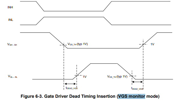

I wanted to inquire about DRV8161 Configurable Dead time. The information provided in Application Brief  SBAA698A (Understanding Gate Driver) shows that DRV8161 has no Configurable Dead Time which contradicts the data sheet. Can you please clarify if DRV8161 supports Open Loop Dead Time or Closed Loop Dead Time or Both? Thanks in advance for the help, Mostafa
