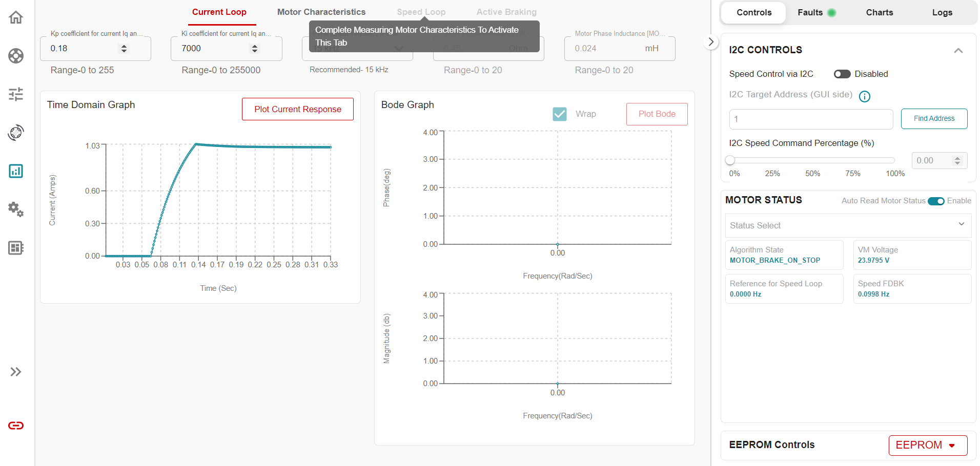

I am working with the MCF8329A and am facing issues during MPET parameter extraction.
Initially, when running MPET, the motor entered a fault condition and sometimes reported an abnormal Back EMF. To avoid this, I increased the Abnornal BEMF lock threshold (% of expected BEMF)  to 70%. However, even with this change, the motor does not spin at all.
I tested with two different drone motors, but the behavior is the same for both.

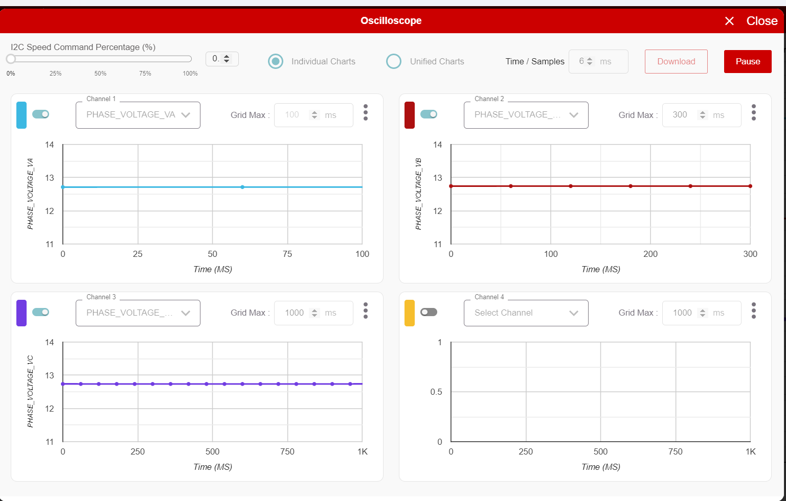

After entering  Kp, Ki and manually measured electrical parameters like Rs, Ls, Ke. Motor is directly going to CC. We dont know mechanical parameters properly. So I initialized all the registers to zero and manually run using hardware pot.
Motor entering to Ke measure mode and keep on estimating back emf even after 5mins. The same happens with 2 different motors. The same happened with mechanical parameters estimation too.

  • Hi ,
    What is the max speed of the motor which you have entered? If the max speed is lower, then the KE measurement may not work due to low speed, and if the max speed is very high, the device may not be able to run the motor in open loop to the handoff threshold, at which point the device measures the developed BEMF.
    Either one of the above-mentioned reasons can be affecting it.
    The next question is regarding the base current configuration as per the shunt resistor — please verify this on priority.
    I also recommend the MCF8329JHS and leveraging the SmartTune feature available in the latest MotorStudio to auto-tune the motor.
