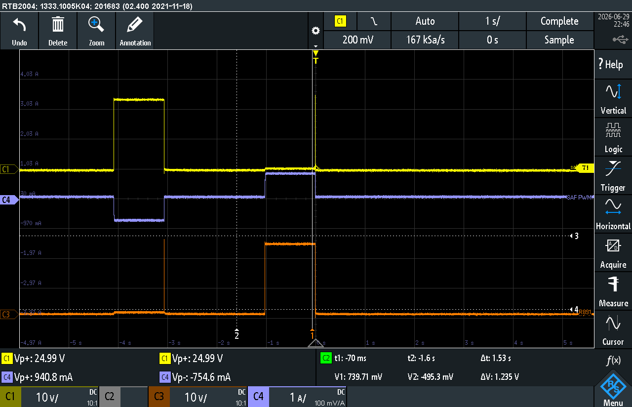

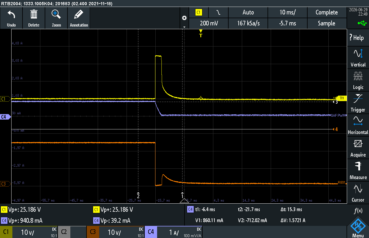

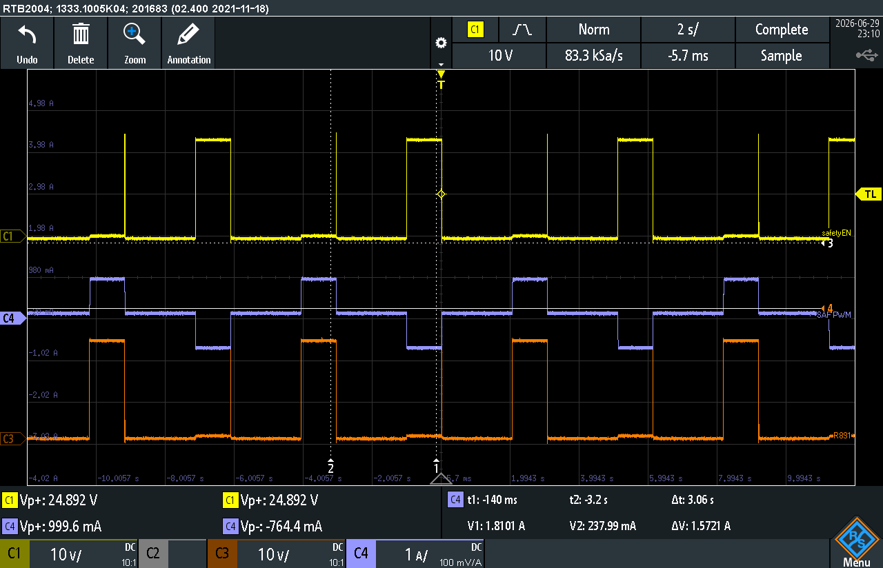

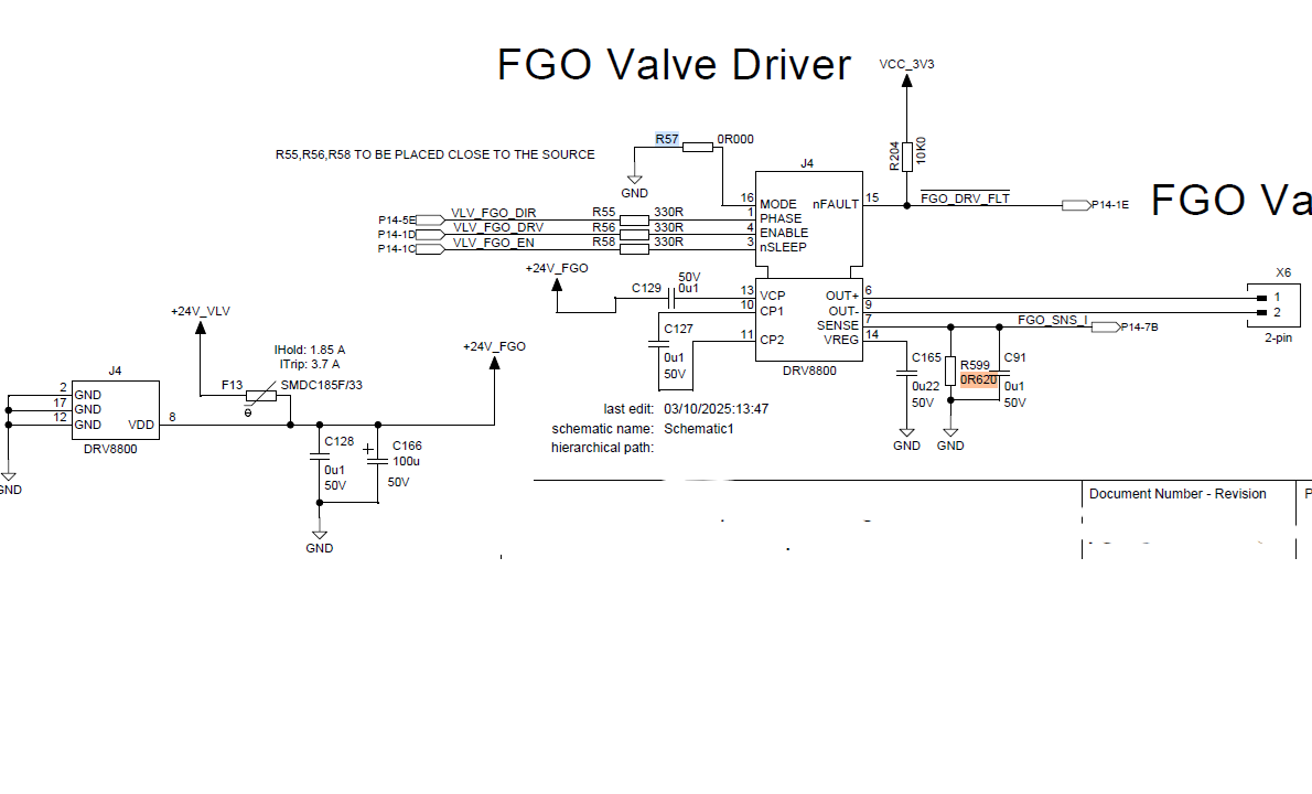

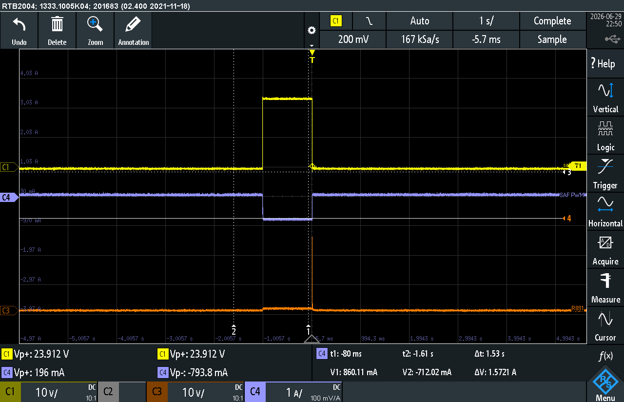

Hello team,
I'm using this IC to drive 3-way bistable solenoid valve with 1 second kick duration. I request you to verify the waveform across coil and it they are ok as per expectation.
Below are the snapshots of schematic and waveform, please check.
Yellow and orange are voltage across coil and purple is current.
