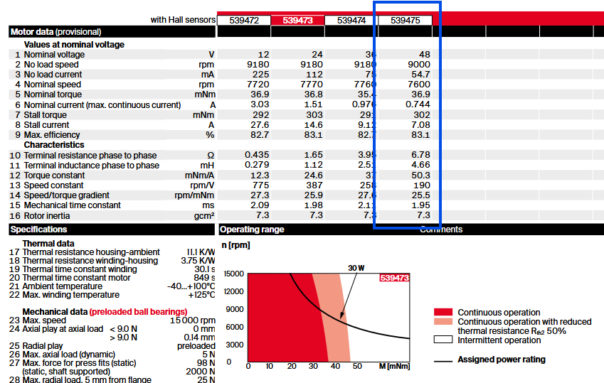

I am currently stuck trying to identify a bldc motor through Instaspin. I ran lab2c with lots of different combinations of user parameters, but the motor would not ID. It would fail around the LS_d/LS_q identification. After those initial runs I decided to try lab 2a instead. It was during this run, the motor started smoking at the beginning of the ID process. It did not make it to the ramp up portion. I more than likely will be getting a new motor as this one is toast. This is the second Maxon motor that has been damaged when trying to ID. Is there anything I am missing for the next potential commissioning process?
 Here is my setup that I am using:
F28069M LaunchPad
DRV8301
Maxon EC-I 30, part number: 539475
48V power supply
Here is the data sheet for the Maxon motor in blue.
Here are the variables provided by the Motorware excel sheet:
