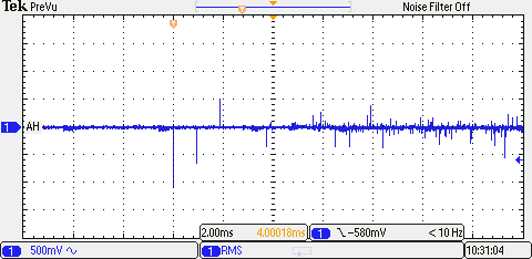

    1) I've tried a gain of 80, 40 and 20 but the last tests were made with a gain of 40. Sometimes (seldom) the registers are not reset on startup of the motor. In that case the voltage at op output is 4 times higher that with the default gain of 10. I can attach scope pictures and the register values i've programmed tomorrow (it's10:30pm here in germany) when i'm at work again.
    2)The buck converter inside the DRV8301 generates 5V and the 3.3V for VDD_SPI and cpu is generated from that 5V via a second buck converter.
    3) PVDD is 28..42V out of a lion battery but currently i'm using ca. 39V from a power supply. A 1800uF capacitor attached on PVDD is located near DRV8301.
    I attached a scope to PVDD, VDD_SPI and the voltages where ok. I measured DVDD and there was only a ~100mV ripple at startup. If needed i can attach scope pictures of voltages and spi communication.
    Gerd

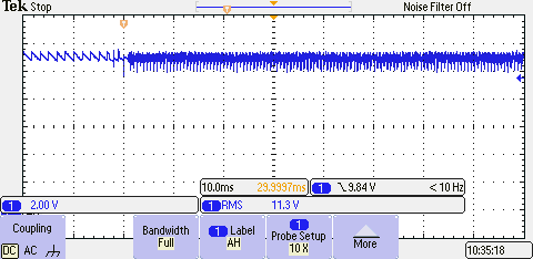

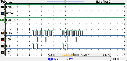

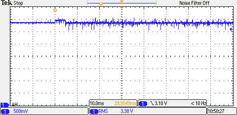

  • PVDD1 38.4V startup of motor
    GVDD
    AVDD
    VDD_SPI
    DVDD

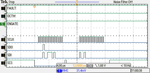

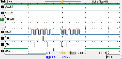

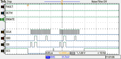

    Write of CR1
    Read of CR1 (0x03A0)
    Write of CR2
    Read of CR2 (0x0008)
    After motor startup CR1 is 0x0000 and CR2 is 0x0000
    Gerd

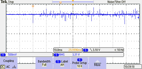

  • Just noticed that if iset gate driver peak current to
    1) 1.7A: CR1 and CR2 are reset
    2) 0.7A: CR1 and CR2 are not reset but at higher rpm they are
    3) 0.25A: CR1 and CR2 are not reset but at higher rpm they are
    Noticed no difference in rpm between (2) and (3)!. So it looks like a voltage problem due to high gate currents?
    Gerd

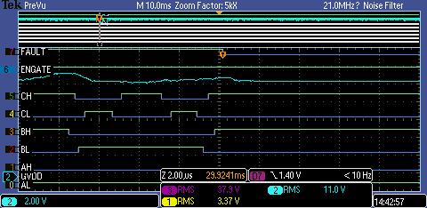

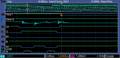

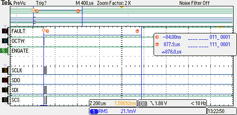

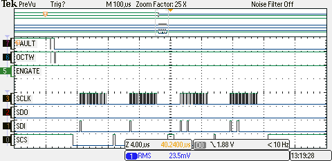

  • Starting with (3) from previous post i've made a fault interrupt routine reading out the status register 1/2:
    As you can see nothing is read back (no address bit set on SDO while read of SR2)! The whole fault duration is ~890us:
    Gerd

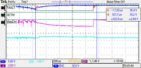

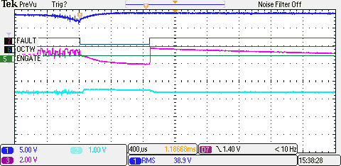

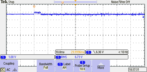

  • I measured PVDD (blue), GVDD (pink) and DVDD (cyan):
    Same (enlarged) with cursors on PVDD: Fault was generated at ~36.4V instead of normal voltage of 39.2V. Should be far away from uv reset.
    Gerd
  • Gerd,
    Try inserting some series resistors between the gate driver outputs and your FETs.  We have 1 ohm on our EVM, but you should try up to 10 ohm.  This would eliminate any "false" OCP trips that might be occurring due to the fast switching edges.
  • Ryan,
    thanks for the hint - i'll try it out and report the results. Currently i'm using 4R7 between gate driver output and gate of BSB028N06 (Infineon).
    Gerd

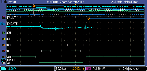

  • I did some more measurements and it looks like that the reset is triggered be a few different PWM patterns. Below one example:
    Pattern on phase A/B
    Pattern on phase B/C
    Pattern on phase A/C
    Any ideas where to focus on? Charge pump capacitor? GVDD cap? Bootstrap cap?
    Gerd
  • Gerd,
    Have we completely eliminated OC?  This can be done via the control bits in control register 1.  The series resistors seemed to help move out the trip point, so I still feel like we are getting "false" OC trips here.
