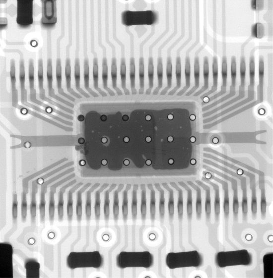

During the first tests the gate drive section has broken down after a few hours of work. The buck section is still working but the gate drive is not. All the charge pump voltages are at 0V.

  • We have done an x-ray analysis and the PVDD1 internal track results clearly vaporized. The adjacent track is also damaged. It seems the result of an output short circuit but the system was standing on a desk when it stopped working.
  • Simone,
    Wow....the finger of the leadframe is completely taken out.
    Something else must have gone wrong on the die that caused a lot of current drain on the PVDD track.  A difference in capacitance on GVDD would not cause something like this.  I have never actually seen a failure like this and not sure what could cause it without taking a closer look at the die.
    Where did you get the device?  If you ordered through distribution, please return it through the distribution channel and we can do a formal failure analysis on it.  If you sampled it, you can call TI support line to return the device.

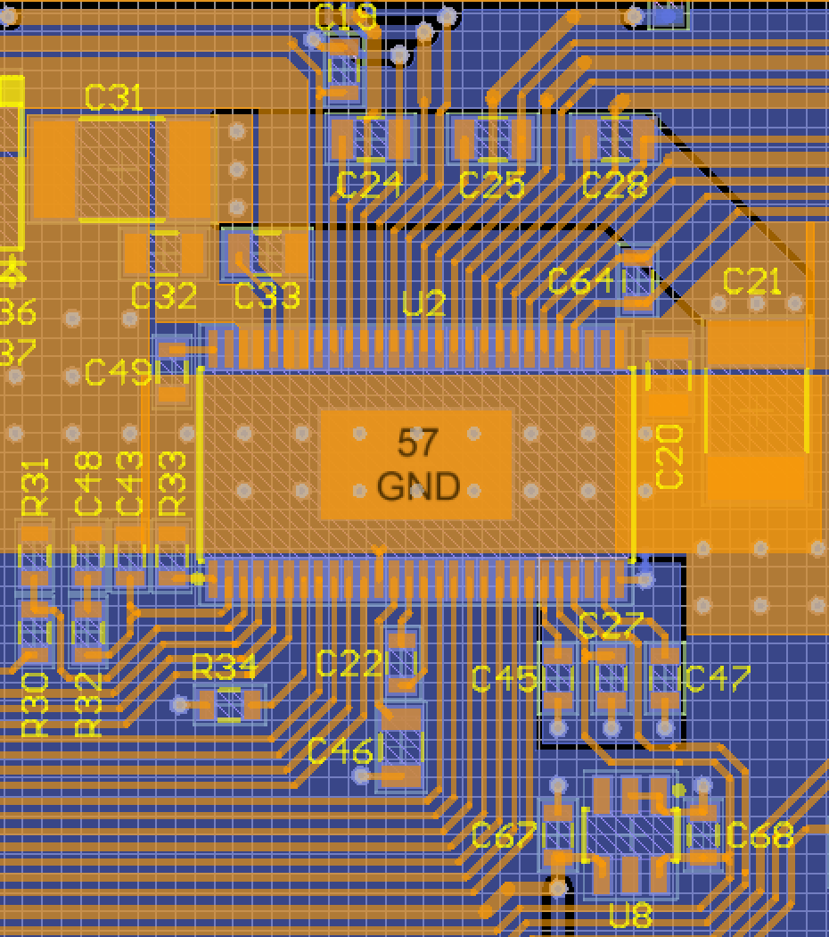

  • Hello Ryan,
    Thank you for your reply.  I agree, it seems to be very low power levels to be seeing any failure.
    Here is a screenshot of my layout around the DRV8301 chip.  The design is a two layer board (2oz copper on both sides) and I have vias beneath the DRV8301 chip which is soldered to the board through its PowerPAD.  I have ground planes both on the top layer (underneath the chip) and on the bottom layer which are stitched together with vias both underneath the chip and outside of it.
    I'll also note that I was able to run a motor (at low currents) successfully for an hour without the DRV8301 heating up.  When it did fail it heated up very quickly.

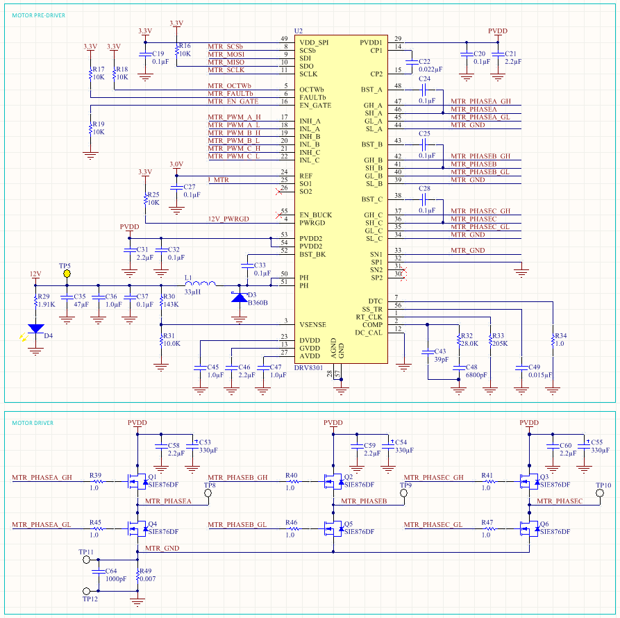

    Can you also post your schematic and part numbers for your FETs (if not already easy to find in the datasheet)?
  • Hello Ryan,
    Please see my schematic attached.  The FETs I am using are Vishay's SIE876DF-T1-GE3.
    Thanks again,
    Jessica

  • Jessica,
    The schematic looks good and layout around DRV8301 also seems to follow best practices.  FET specs are also inline.
    Other than the current you are drawing out of the buck (??), there is really nothing else in the chip that would cause temperatures to climb to 65C under normal operation.  You are also operating at 30V which is well withing our operating range.
    If we rule out over-voltage spikes (>60V), then the only concerns left that would cause device damage are negative voltage transients during current re-circulation and GND bounce.  Can you send me some scope captures showing GH_x, GL_x, SH_x, and SL_x for one of the phases?  That would help me rule out negative voltage transients.
    If spikes are a concern, you could try to slow down the edges by weakening the gate drive in control register 0x02.  Set D1 = HIGH and D0 = LOW...see Table 7 in the datasheet.  You could also increase the series resistors on your board.  Give that a try along with the scope captures.
    Finally, if you measure the difference between GND points on your board....are the differences fairly smal  (<0.3V)?
