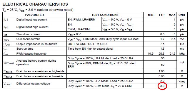

I have some piezo actuators I need to drive at 60V, and as the main page of the the IC as quoted here says:
The DRV2665 is a piezo haptic driver with integrated 105 V boost switch
However, after reading the datasheet as emailed to me, I read that the output ranges only up to 3.3V? What does the "105V boost" mean here? Can this IC be used to drive the piezo actuator as mentioned?

  • Hello A. Halim,
    I think you may be misreading it?  Could you point us to where you are seeing this information?
    On the posted Datasheet in the product folder the 3-5.5V supply range is on the input for VDD, the output swing out of  OUT+ and OUT- is where the +/-105 Volts comes out thus giving a 210VPP range with a breakdown as follows:

  • Hi Eric,
    Thanks a lot for your reply. So this means that the output voltage is dependent on the capacitance of the piezo actuator, am I correct? I obtained the info from the datasheet as attached, but it is for DRV2603 though:
    My power electronics theory is a bit rusty, you see. The capacitance of the actuator is 1150nF though. So how do I go around this? Do I add capacitance in series to tune the capacitance down to 330nF?
    Thanks a lot for your input.
  • Ah, that's is the problem, the DRV2603 is not a piezo actuator driver, that is designed for ERM and LRAs (typical DC motor-esque applications). If you need to drive a piezo actuator please refer to our piezo driver selection page. And yes the size of the actuator's capacitance dictates how well the driver can drive it, the previous post gave you some performance points of our drivers.
    To answer your circuits question yes, capacitors in series reduce via ((1/C1) + (1/C2) = (1/Ctot)), where as capacitors in parallel sum up (C1 + C2 = Ctot).
    That being said we aren't sure if that trick works for actuators and allowing them to maintain their vibration strength and operating conditions.  Let us know how it goes?
