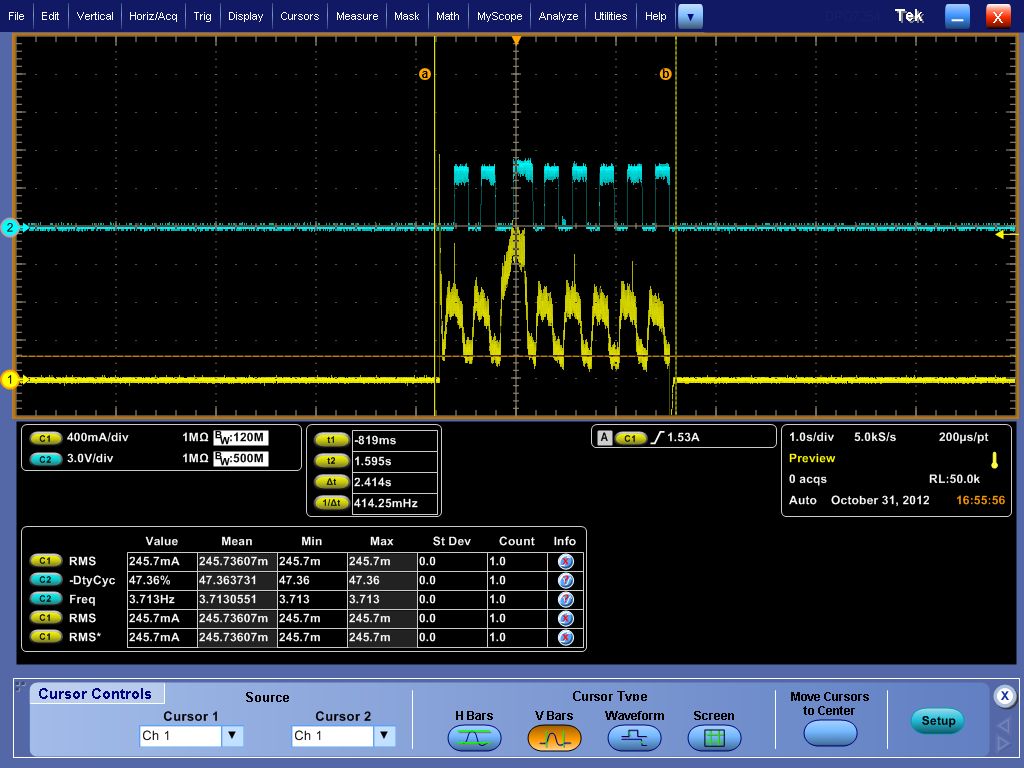

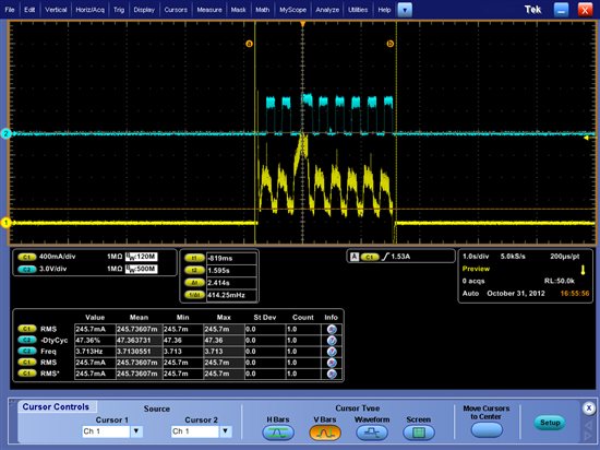

  • Hi Jose,
    Measurement is done on the motor winding side, the output of the driver. You may find the plot as below.
    Anyway, would like to check with you on the OCP level, what does it means when the min is 1.5A, max is 4.5A and typ of 3A when the absolute maximum rating is 1.5A. Moreover, based on the datasheet, the current rating can be tweak via the Vref and Isense. If it is said that the device capable of only 1.5A, meaning this function serves only for designer to limit any current less than 1.5A before it trip?
