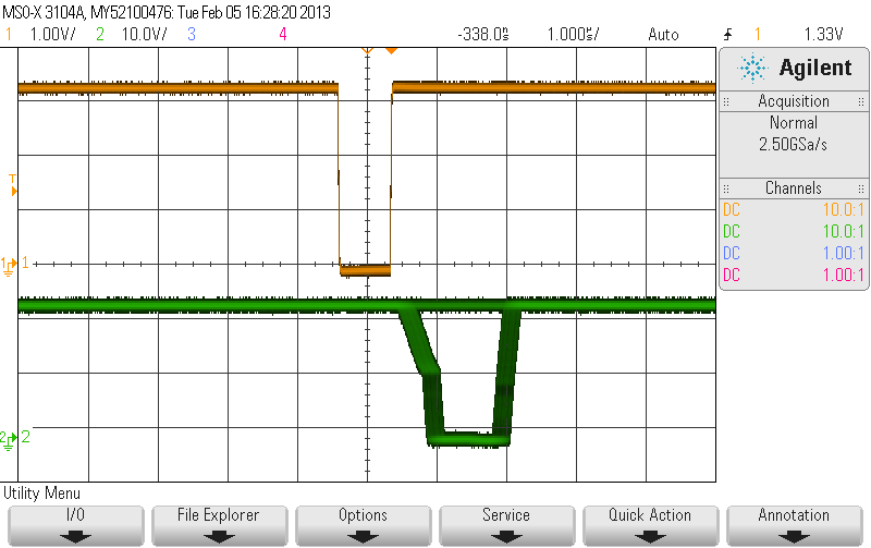

Hi. I have been looking at the eval kit for the DRV8840, with the intention of using it to drive a TEC (thermoelectric cooler).
There seems to be quite a lot of 'jitter' on the output waveform, compared to the input PWM from the MSP430. This gets worse at very high duty cycles, to the point where there seems to be some LF modulation going on. Unfortunately, this starts to give audible noise from the L-C filter I have between the output and the TEC.
In the image below, top trace is the 3.3V PWM on the enable pin, bottom trace is on OUT2 with respect to GND.
I have the current limit disabled as best I can (I0-I4 all high, VREF to 3.3V). I tried shorting out the sense resistor just to be sure, but it made no difference. It also makes no difference if the DRV8840 is connected to a load or not.
Is this normal, unavoidable behaviour for this part?
  • Jonathan,
    If I am reading the scope capture right, this is a <=1us pulse you are issuing on the enable.  I think what you are seeing is our deglitch circuit acting on this narrow pulse.
    I need to check with design to see what our deglitch timing is on the ENABLE pin as I can't find this information in the datasheet.
    If you increase the low time, does the problem go away?
  • Hi Ryan,
    Yes, the scope capture is 1us/div. I was unaware of the deglitch circuit, but it would explain a lot.
    Running the EVM software, I see pulse-skipping on the outputs typically at 98 and 99% duty cycle. This is the point where the off-time becomes < 1us. There can be milliseconds between output pulses, hence it puts it in the audible range, and increases the ripple to the TEC as my LC filter is no longer effective.
    I was planning on running at 62kHz to keep my filter smaller (the EVM runs at 31kHz). I now see this will make things worse by way of narrower pulses.
    The TEC will be driven by PID control, so if it's far from the set-point it will run flat-out until it gets close, then it will pass through this high duty cycle region as it backs off. I suppose I could restrict the maximum duty at the expense of response time and range.
    There is also a 300 to 400ns jitter on rising and falling edges of the output pulse (for any duty cycle), which is contributing to audible noise, although nowhere near as badly as the pulse-skipping.
