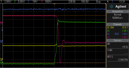

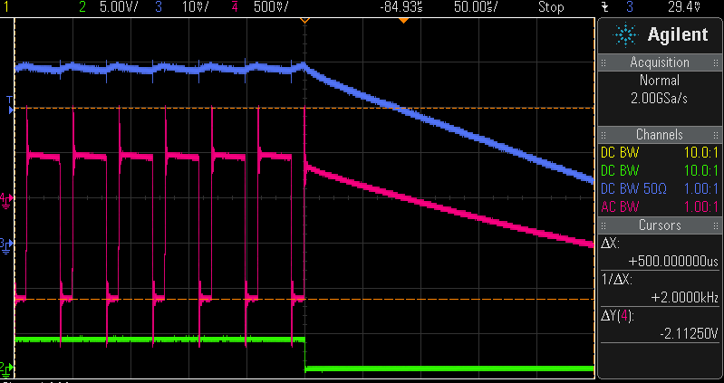

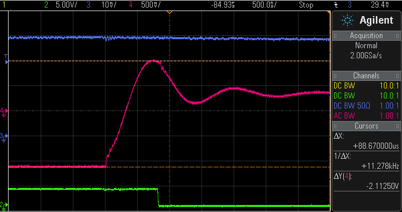

  • Hello Ryan,
    I have made some measurements of the switching current in the DRV8332. Before, I refered to my motor phase current as the peak current, but the switching current in DRV8332 turned out to be much higher than the output current.
    In these measurements, I have used an OC latching shutdown mode with a 22.6kOhm oc_adj resistor. I recirculate the current in the lower FETs (slow-deacy mode).
    Ch2=FAULT signal
    Ch3=Motor phase current, 10mV=2A
    Ch4= Current through low-side FET (ac-coupled), 200mV=1A.Conducting during the PWM off-period.
    The measurement of Ch4 shows the low-side FET been switched on to reciruclate the current. This is when the OC shutdown occurs.
    From the measurement it is clear, that the switching peak current is around 3A higher than the motor phase current of 8A.
    This is quiet a shame, as I was hoping to be able to use the DRV8332 with a 11A peak motor phase current capability. It seems to me that it is not possible to reduce this switching peak current, but I would still like to know if it is normal to have such a high switching peak current in the device?

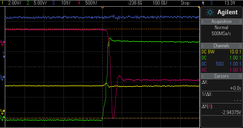

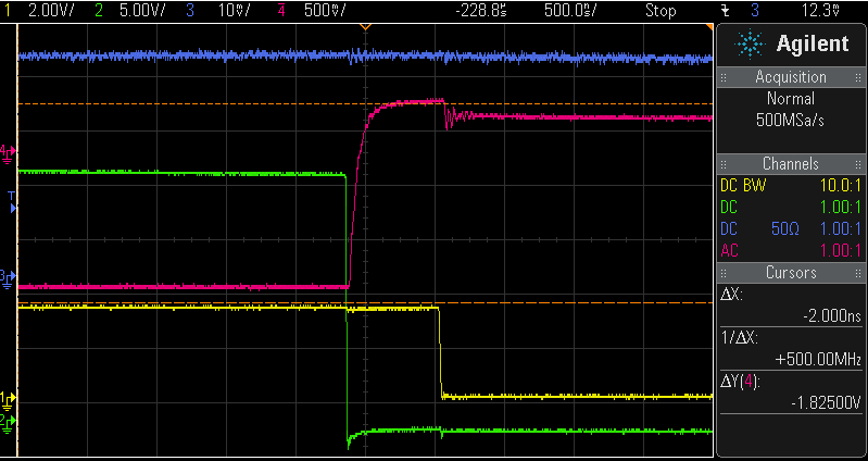

  • Hello Ryan,
    I found out that the peak current oscillation was caused due to a high capacitor value of (10uF) in parrallel with the sense resistor. I removed this capacitor and added a snubber between the motor phase and ground.
    I have made new measurements, now the oscillation is removed, but the motor driver still goes into a FAULT mode at only around 8.5A phase current. Now I cant really see that I have an over current in the system during the shutdown. So what is causing it?
    Ch1: FAULT
    Ch2: Motor Phase Voltage
    Ch3: Motor Phase current (10mV=2A)
    Ch4: Sense Current, lower FET (200mV=1A)
    This measurement shows the transition when the lower FETs start to conduct during the current recirculation period.
    This measurement shows the start of the on-period:
