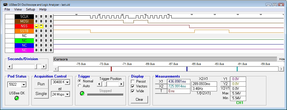

    I am using the DRV-8823 via SPI to a Silabs C8051F806 MCU.  I hard wired the ResetN and SleepN pins to high at VM, so I don't know why my DC motors are not spinning.  I probed the SCLK, SCS, SDATA, and SSTB with a logic analyzer, and I verified the message is being sent from the Silabs MCU.
    I verified that the SCLK period is within spec, at 330ns and I made sure I manually toggle the SCS and SSTB signal as drawn in the DRV-8823 datasheet.  I am attaching the readout from my logic analyzer.
    Kim
  • Hi Kim,
    From the logic analyzer, it is difficult to determine if SSTB goes high before SCS goes low. Can you confirm that SSTB goes high at least one clock prior to SCS going low? If SCS goes low prior to SSTB going high, it is possible that the transfer of data did not occur.

  • Rick,
    Thank you for the quick response.  I changed my code to allow the SCS to go low prior to SSTB going high.  However, my motors are still not spinning.  Can you suggest a pair of Hex numbers I should send?  I sent 0x17 follow by 0xDF in the screenshot attached.

  • Hi Kim,
    The command sent is to address 1111, which is not a valid address in the DRV8823.
    First, let's activate the outputs with no motor. The simplest way to do this is to send 0x0fff to ADDR0. If successful, this command will set the AOUT1 and BOUT1 to VM, and AOUT2 and BOUT2 to GND. This will confirm that the SPI commands are working.

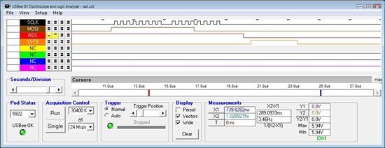

    Thank you for your instructions.  I have read the source code, and after many days, I understood the code and have copied written this code to my own Silabs microcontroller to implement software SPI.  I see that I send the LSB to the DRV first.  I am able to write whatever 16bit messages I want, but I cannot get the motor to spin.
     I am attaching a screen capture of my logic analyzer verifying the 0x07DF word I sent to the DRV chip.  This message was suppose to activate Motors A and B in forward direction at full power without decay, in compliance with Table 1. on DRV8823 datasheet.
    I tested my four DC motor and they all work.
    Right now, I have 4 DC motors connected to the DRV8823Q, so I do not need to implement a stepping routine.  I thought that I could simply send a 16 bit word to the DRV8823 chip and have it execute.  I am very discouraged at the moment and I am contemplating cutting my two months loss trying to get this TI chip to work and looking for a different chip vendor.

    What was the result when you sent the 0x0fff command to ADDR0 without the motor connected? Did the outputs enable properly?
    What is the result when you send the 0x07DF word above? Did the motors attempt to turn? What is the motor parameters/ part number?

  • The motor terminals read 0v when I sent 0x0fff command. I am attaching a screen capture of the logic analyzer readout.

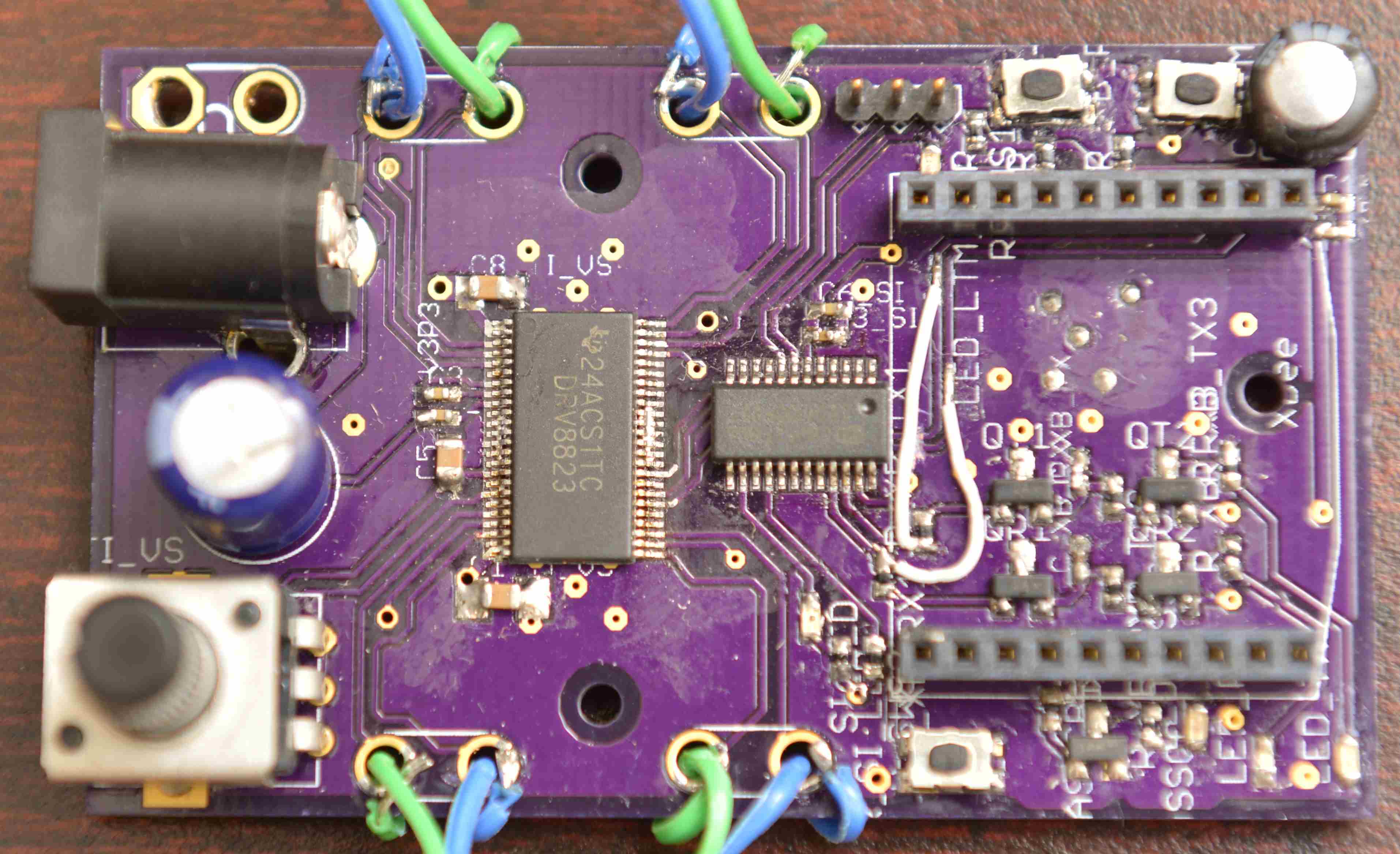

    I incorporated as many capacitor as the EVM showed.  I am attaching a photo of my board, schematic, and layout.
    I measured the VREF to be 2.8v.  PowerPad is soldered to GND.

  • Hi Kim,
    Thank you for the detailed information. Knowing that you have 0V after sending the command, and seeing your schematic have been very helpful.
    It appears as though the device is still in sleep/reset mode. Please note that both SLEEPn and RESETn must be a logic high for the outputs of the device to be enabled. By default, there are pulldowns on the two inputs. You can confirm that the device is in sleep/reset mode by measuring VCP. If in sleep/reset mode, VCP will be much less than VM + 12V.
    If VCP is not VM + 12V, the outputs are not enabled. This must be corrected prior to sending the enable motor command. Assuming VDD is >2V and < 5.5V, please connect SLEEPn and RESETn to VDD. This should enable the charge pump to operate at VM + 12V. Please report the results after connecting SLEEPn and RESETn to VDD. Did VCP increase to the expected value?
    If VCP increased to the expected value, please resend the command to enable the outputs without the motor connected. Please report these results.
    Thank you.
  • Rick,
    I am currently using 8 AA batteries giving me 10.35V for VM.  I soldered SLEEPn and RESETn pins together and then connect it to a port on my MCU.  my MCU is powered by 3.3V VCC.  I command my MCU to send HI to SLEEPn and RESETn, but I only measure 10.35V on VCP.  I measured my MCU output port and it was much less than 3.3v, I forgot the exact number, but it was around 0.7v.  (on hindsight, I think I did not enable Push-Pull on that port, but left it at open drain)
    I then soldered the SLEEPn and RESETn directly to VCC source, and I was able to measure it at 3.3v.  Immediately, VCP now measures 20.38V.  I was then able to send the 0x0fff to Motor A and Motor B spun up.   I then sent commands to Motors C and D and was able to turn it on and off.  '
    Rick, thank you so much for your help.  I wished the Datasheet would have said that  SLEEPn and RESTn are by default pulled down and that the DRV8823 would not run unless these pins are set driven high.  I interpreted the statement "Active low input disables outputs and charge pump" as "when driven low, disables outputs and charge pump", so I did not think it was necessary to connect them.
