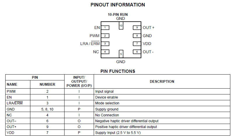

Can someone supply the pinout for the DRV2603,It does not appear to be in the data sheet.
Des,
Can you please request the full datasheet which contains the pin out information? The request link can be found on the DRV2603 product webpage.
