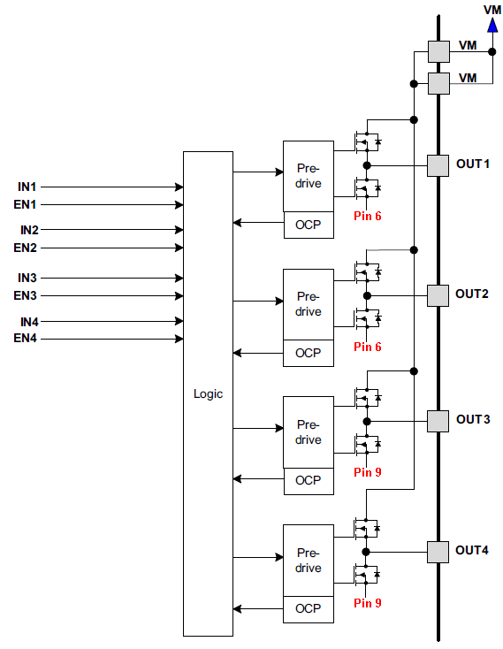

I'm using a number of DRV8844 chips in my solution and am curious to know if there is any way I can sense motor current.  I am using two outputs of the quad H bridge (a full H) to drive a DC motor.  I have placed a sense resistor on one of the outputs, but thise seems to be producing strange results.  I noticed that there are four connections to ground, presumable 1 per half bridge, can I place my sense resistor between this connection and ground to achieve current sensing?

  • Thanks for the quick response.  Unfortunately, we are commited to using the DRV8844 as majority of the board layout is already done.  Is there any way to confirm the ground pin issue?
    If I want to sense 1/2 bridge 1, does the sense resistor get connected between pin 6 and ground or pin 5 and the device. Will either / neither work?
    If I want to sense 1/2 bridge 2, does the sense resistor get connected between pin 9 and ground or pin 7 and the device. Will either / neither work?
    If I want to sense 1/2 bridge 3, does the sense resistor get connected between pin 14 and ground or pin 8 and the device. Will either / neither work?
    If I want to sense 1/2 bridge 4, does the sense resistor get connected between pin 28 and ground or pin 10 and the device. Will either / neither work?
    Looking more closely at the block diagram, it seems there are two grounds connected to the output stages of the chip (1 pin / H bridge?), and two ground pins.  Can someone provide clarification?

    I confirmed with the device designer that this picture is accurate.
    Basically, Pin 6 is the low-side for OUT1 and OUT2, so you should be able to connect a small sense resistor from Pin 6 to GND, and its voltage will indicate the absolute value of the current through OUT1 to OUT2.  Alternatively, you could place a sense resistor in series to OUT1, but its voltage polarity would change with your motor direction.

  • I want to use the DRV8844 instead of a DRV8432. For controlling stepper motors with microstepping. The DRV8844 with 60 V power supply gives ne a little bit more saftey for 48 V powering. For control I use a TMS320F28069 processor. I'm using a triagular (symmetric) PWM. At EPWM counter zero the lower transistors of both halfbridges connected to a fullbrige are closed and the current is circulating in the lower part of the fullbridge. Because each half bridge has its own GND I can measure very easy the motor current at this time. According to the picture the DRV8844 has no individual GND Pin for each half bridge. Therefore I can only measure the current during the on time of the PWM. Is that correct? That is a big disatvantage for a low cost current sensing.
  • Hi Christoph,
    Correct, there is no individual GND pin for each half bridge. From the picture posted above (dated June 11, 2013), each full bridge has its own GND.
    For stepper operation, this is sufficient.
    If configured properly, current can be measured during both on time (positive voltage across the resistor) and fast decay (negative voltage across the resistor). Since current re-circulates through the low side during slow decay, there is no current in the resistor.
