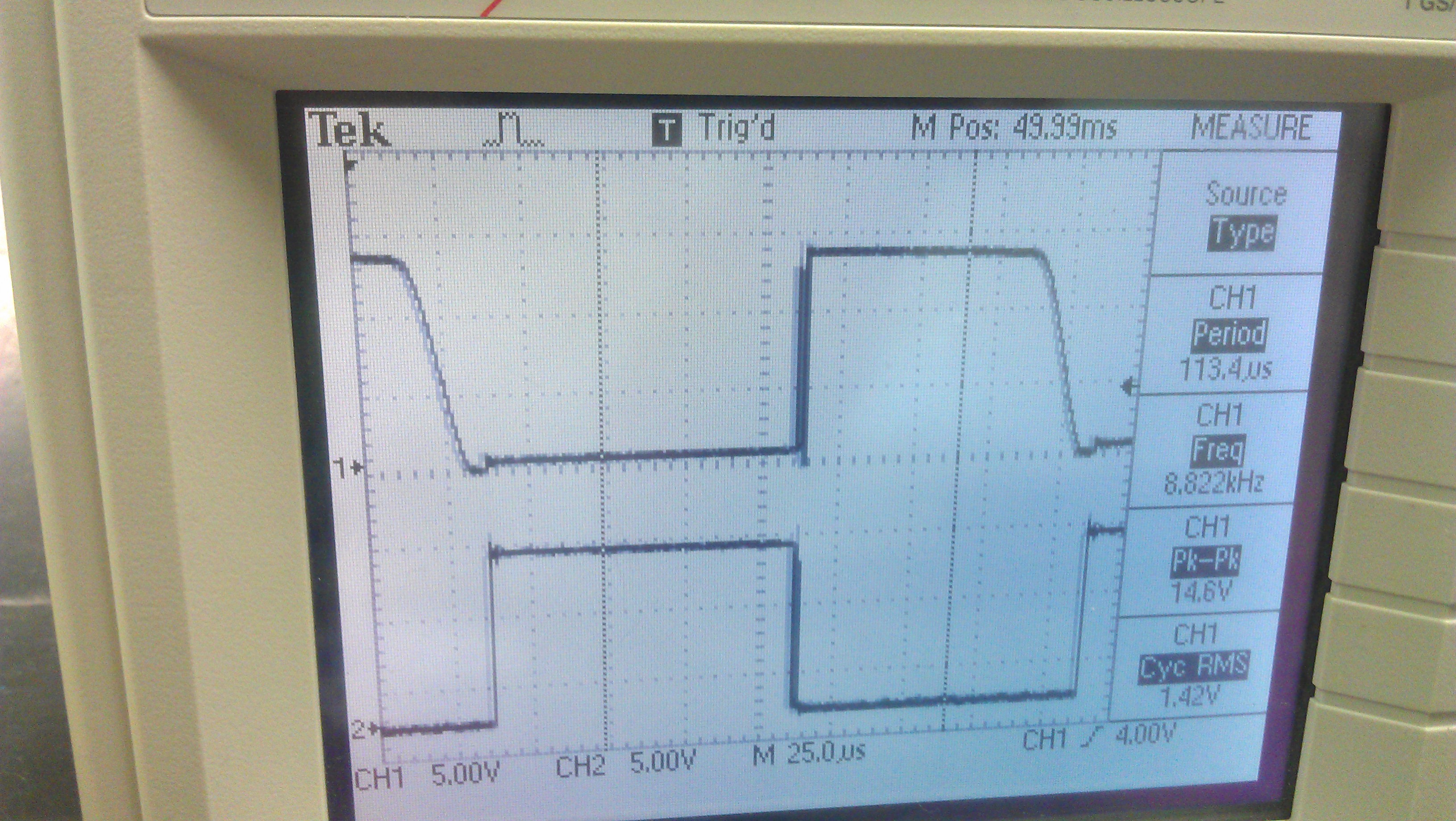

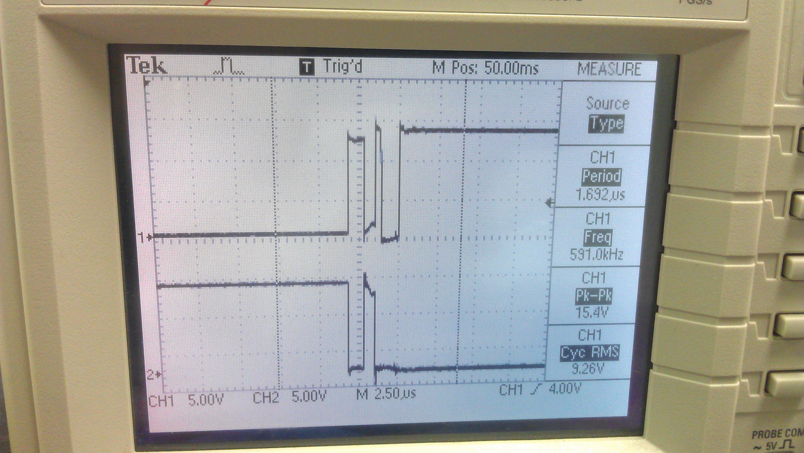

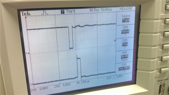

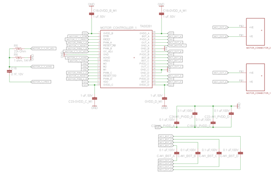

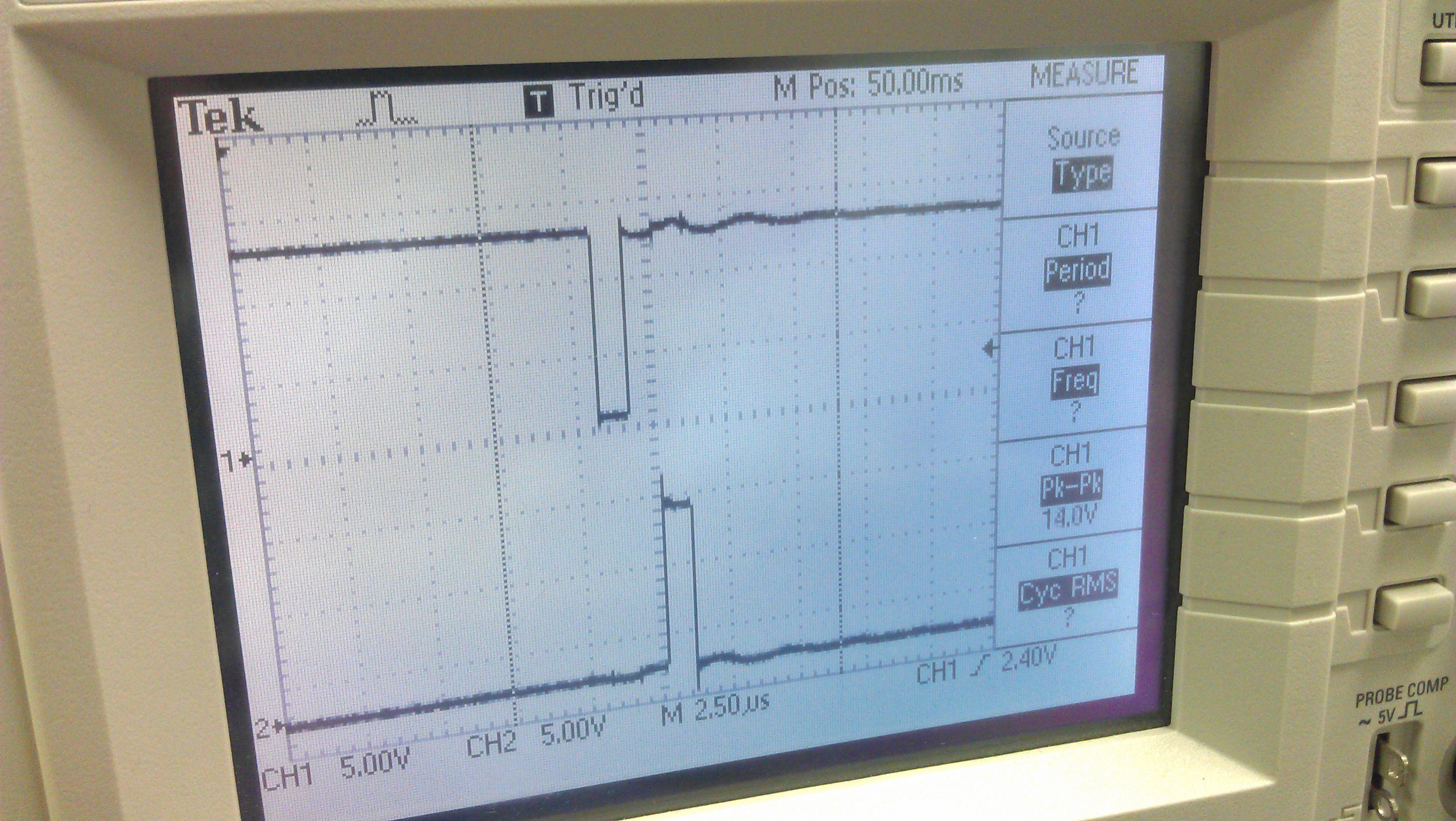

We're using a DRV8432 in a Dual FB, CBC current limit configuration.  We are experiencing problems when we change the current limit resistor.  Originally, we started with a 22k resistor and operations work as expected.  When we try to adjust the CBC with a 47k resistor (we are trying to limit current to around 6A per motor), we see reduced function and sometimes freezing.  We put an scope on the motor ports while the motor was attached, and you can see power on one of the poles start to collapse.  We are running PWM at about 10khz.
This is our schematic:

  • Hi John
    If PWM too low, even lower than the motor phase switching frequency, the driving step may be confused by the PWM and OCP function. then the motor may not get constant torque from one direction.
    Now first you can try start the motor with lower PWM duty, this will reduce the chance that trigger OCP at your already lowered OCP threshold with 47k resistor.
    Second, if you do need low PWM to drive, you can refer to the post http://e2e.ti.com/support/applications/motor_drivers/f/38/p/263135/925259.aspx#925259 including the dealing with LOW pwm that how to select boost cap. DRV8312 and DRV8332 will be mostly alike in the boost strip circuit.
    I really think we can use higher PWM like 20k which make less noise and smooth control. Heat should not a big problem at this condition. of course you need a solid good heat sink even is test.
