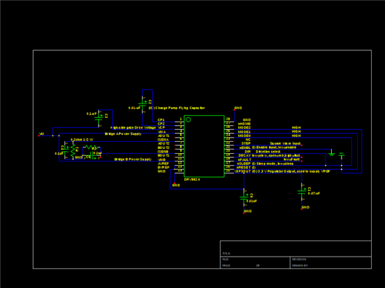

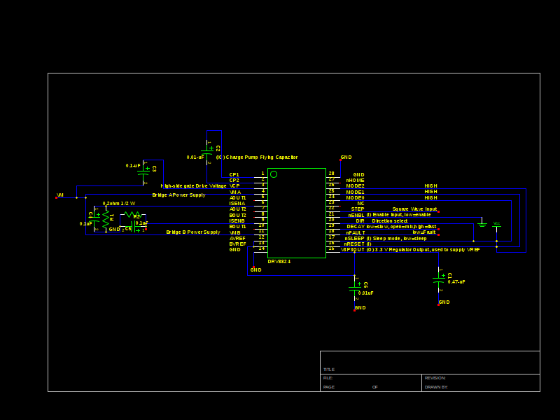

I am trying to implement a circuit using DRV8824 IC which will drive a bipolar motor in microstep mode. The problem arises when the STEP input signal exceeds 600Hz. The output is highly distorted. But the same works just fine for a 100Hz STEP input signal. However my application requires very small pulse duration and therefore I have to work at a higher frequency.
All the connections are as per the data sheet.
Voltages measured are as follows:
VCP=23.4V
VMA=VMB=12.8V
AVREF=BVREF=V3P3OUT=4.01V
DECAY=OPEN
Here is the Schematic:

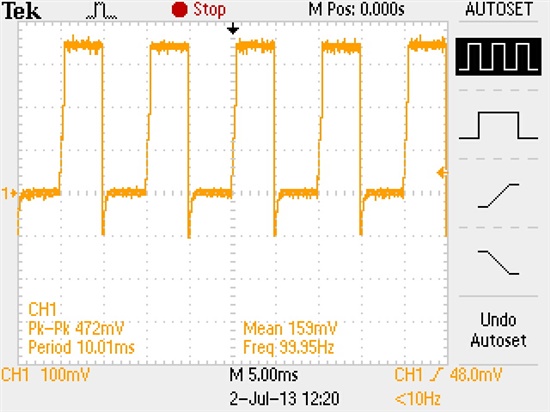

The 100Hz output is as follows:

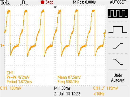

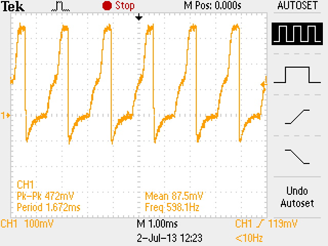

600Hz output is as follows:
  • Hi Ravi,
    Are you intending to drive this in 32 microstep Step Mode? The input on step only controls the indexer not a direct relation to the output. There are 4 outputs on the chip that will control the stepper through the indexer.
    Also, V303OUT/VREFX should not be exceeding 3.5V according to the datasheet. This makes me think something else is the issue and you are just seeing oscillations from the input on the output pins.
    -Nick
