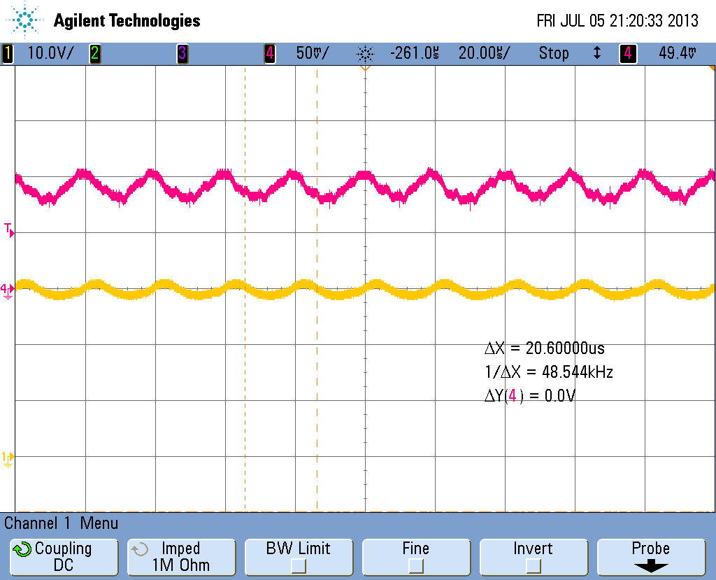

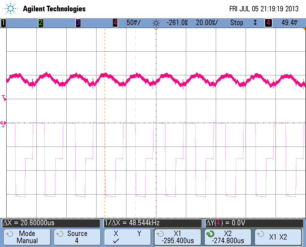

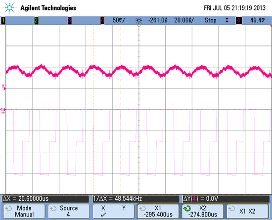

    4) Attached is Imotor(CH4)/Vmotor and Imotor(CH4)/Vsupply(CH1).   Imotor probe is 100mv/1A.  Vmotor is 20V/div.   Note there is no motion during this capture.  Same with motion.  Vref=0.96V.  I[4:0]=0x18.
    Dan
  • Dan,
    I am still investigating your issue. Based on your scope shots, I don't see the cause of audible noise. The PWM signals are operating at ~50kHz; well above the audible range.
