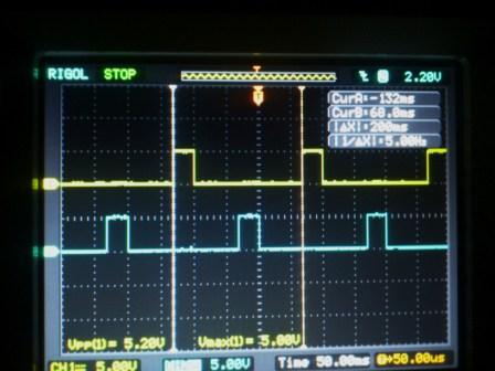

    IN1 is a 32 ms positive pulse repeated every 200 ms. IN2 is similar to IN1 but delayed 100 ms in relation to IN1. The voltage levels are 0V and 5V.

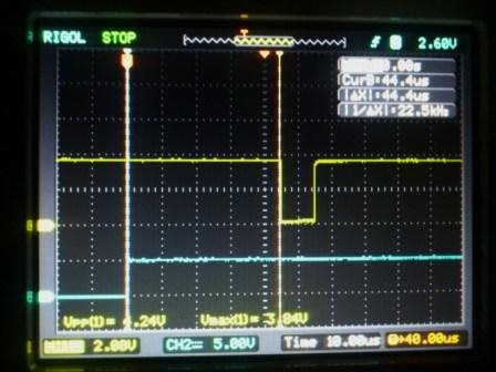

  • Hi again,
    the first picture shows IN1@channel 1 (yellow) and IN2@channel 2(blue).
    The second picture shows FAULTn@channel 1 (yellow) and IN2@channel 2 (blue).
    There is no load on the outputs OUT1 & OUT2.

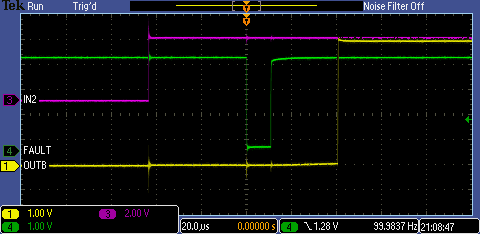

  • Hi Tomas,
    Sorry for the delay, but I do have an answer for you.
    This FAULT pulse you are seeing is actually a function of the DRV8832 coming out of its SLEEP state (IN1=0, IN2=0). The FAULT will pulse due to deglitching of the UVLO signal. If you look at the OUT2 signal you will see that it does not assert until after this pulse occurs (see attached scope shot). In general you will never want to hold both outputs low when driving a DC motor which is the reasoning behind this functionality.
    One solution if this delay is not acceptable is to use IN1=1, IN2=1 as you default state and then pulse the inputs low. Alternatively you could find another device that does not utilize this state as a SLEEP state. I will see if I can find a suitable alternative.
