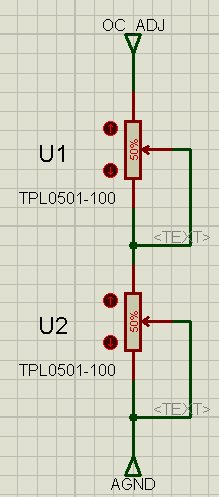

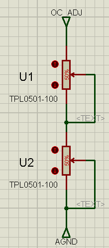

1. Is it possible to set the Roc_adj value by the use of two TPL0501-100 connected in rheostat mode like shown in the figure ?

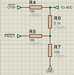

2. Is it possible using a R2R connection (figure below) to convert the FAULT and OTW signals to an analog value and read it using a microcontroller ADC ?

    1. Digital pot should be fine. Any particular reason that you want a full scale variable OC adjustment range?
    2. I know your propose but nOTW and nfault are OD pins. You need pull up the pins and have some modification on your current structure.

  • Hi Wilson thank you for your reply.
    I want to use digital pots so the current limits can be set in software.
