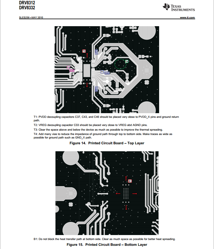

I have a custo board with a DRV8301 driving a 3-phase PMSM motor. When I apply a fixed duty-cycle pwm to the three phases, everything works fine when phases A and C are >50% duty-cycle, and phase B is < 50%, and current drives through the 3 phases. When I swap the duty-cycles around, i.e. A and C <50% and B>50%, the FAULT pin starts to cycle on and off continuously with a 427us Hi time, followed by around 900us low, so a repetition frequency of 758Hz. The PWM frequency is 20KHz. The OCTW pin stays Hi during this state.
I've checked GVDD = 11 volts, DVDD= 3.3V, PVDD= 12V. There's a bit of noise on GVDD, but nothing very significant.
Any ideas on what could be happening ?

  • Hi Geoff,
    The DRV8312 datasheet (pg. 22) has some good suggestions to follow. Be sure to check that all decoupling capacitors are placed as close as possible to the device and have a direct path back to the device GND (PPAD). The decoupling caps on the internal regulators must have a clean path back to AGND as well. This is an issue that we usually see in layouts. The buck regulator issue definitely points to some schematic/layout problems or a damaged chip. Has it ever worked?
    As snapshot of your layout may help to diagnose some of the issues.

  • Hi Nick,
    I've now studied the documents you suggested, and I also have a DRV8301-HC-EVM board which I've been looking at, along with its documentation, particularly the artwork of the board, and especially the ground planes.
    This is my understanding of the situation :-
    1.  The critical components for placement on the EVM board are C7,8,10,14 and 15. On this board C7,8 and 15 all connect to the top layer ground plane which goes underneath the DRV8301, and which the PowerPad solders on to. This top ground plane connects to a bottom layer ground plane via around 39 vias directly underneath the DRV8301. This top ground  plane has no connections back to the power ground terminal other than by the 39 vias throught to the bottom ground plane.
    2.  C10 and C14 don't connect directly to the top ground plane but via several vias each to the bottom ground plane under the DRV8301. I'm assuming that this equates to the 'star' connection recommended in document SLVA552 for all the capacitors C7 to C15.
    3.  The bottom ground plane under the DRV8301 connects via two paths forming a circular route back to the power GND connection and to C50, the large electrolytic across the power-in and ground terminals. One of these ground paths for the DRV8301 also includes the external current-sense op-amp components.
    4.  The motor return currents via the current-sense resistors, R80,81 and 82 have an almost separate ground path back to the GND terminal, altgough there is some mixing of the DRV8301 ground plane with this return path.
    5. The buck-regulator components use the same top layer ground plane connection as C7 to C15 back to the DRV8301 PowerPad.
    6.  The ground connections for the controller card and encoder signals connect to the DRV8301 ground plane on the top layer, but there is also a thin track connection back to the GND connection, close to the external sense amp components.
    Is my assessment correct, and as I haven't currently followed these rules in my layout, is this the most likely cause of my problems ? Have I missed out any critically important points because I don't want to lay out another board, only to find that it also doesn't work ?

  • Geoff,
    It looks like you have done a good job of understanding this issue. C5 and C6 are also critical components and should follow similar rules. C81, C82, C83 should be noted as well. Place these caps close to their assosciated high side FET.
    A more general summary of what you have found.
    1. PVDD decoupling caps (C5/C6/C7/C8) for the DRV8301 should have a direct return path to the device GND (PPAD) that is as short as possible. The longer the path the worse GND bounce/noise will affect the device (Vias add increased inductance/resistance so a path on the same layer is even more desireable).
    2. The internal reguator decoupling caps should have a direct return path to AGND and GND (PPAD). They are connected to the same net on the EVM but this is stated in the datasheet. This path is even more crucial as GND bounce/noise will have a larger effect on the internal logic.
    3. It is a good rule of thumb to stitch the TOP and BOTTOM GND planes together fairly heavily around the device (and board in general to reduce long return paths) in addition to the recommended PPAD vias. You can see this in the EVM layout. Use good sense here as you don't want to completely litter your board with vias.
    4. For the motor return current you want a clear direct path back to the Power Supply decoupling cap and input header. This can be a large current so a wide, short trace is highly recommended depending on your current requirements. Current will return through the sense resistors. This return path should try to avoid the DRV8301 and other devices (controllers) as the high power will also have high noise.
    These recommendations are all highly important and it looks like you have discovered them. (Remember C5 & C6 as well).
    The buck regulator not working is still worrisome. I would like to see you final schematic as I believe you might have an error with the configuration of the buck pins. Also feel free to post you final layout and we can look over it to try and spot any worrisome spots.

    I've almost finished my layout of a prototype board following your recommendations and the general layout of the DRV8301 evaluation board now.
    Can you tell me what formats you can accept schematics and layouts in to give your opinion on what I've done ? My schematics are done in a fairly old version of Multisim, and I could send you the gerbers of the layout, if those are any use to you ?

  • Geoff,
    A few comments,
    1. Could you just set the buck to 3.3V instead of using two different converters? Or do you need the 5V Rail?
    2. VREF should be set to the ADC ref from your microcontroller (just double checking)
    3. What is the purpose of R32 and R33 on PVDD1?
    4. Do you need the 10 ohm resistors on GH_X and GL_C? This may be a little high but depends on the FETs. The DRV8301 also has adjustable gate drive.
    5. A solid copper pour is best for the PPAD to GND connection.
    6. C22 should have a direct route back to the AGND pin. It is best to make this on the same layer.
    This is just what I can pick out.
    I have attached another helpful guide that is in the process of being put together.
    8168.DRV8301-2_Layout_Recs.pdf
  • Hi Nick,
    Thanks for the very quick reply.
    Here's my answers to your comments
    1.  I do need 5 volts as well as 3.3 volts to power a few things including a canbus chip and an external optical encoder.
    2. Although my VREF is labelled 2.5V, there is an option on this prototype board to select between 2.5 volts for external A to D's, and 3.3 volts for the micro's Vref.
    3.  It's missing off the schematic, but the junction of R32 and R33 goes off to an A to D input on the micro to measure supply volts.
    4.  The 10 ohm resistors are there to limit the rise time of the gate drive, which I thought was good to minimise noise on the board. I can remove them if you don't think it's a good idea.
    5. I'll get rid of the thermal reliefs on the PPAD.
    6. I'll alter the layout to connect C22 direct to AGND on the same layer.
    I'll study the layout document you sent the link to, thanks.
    Geoff
