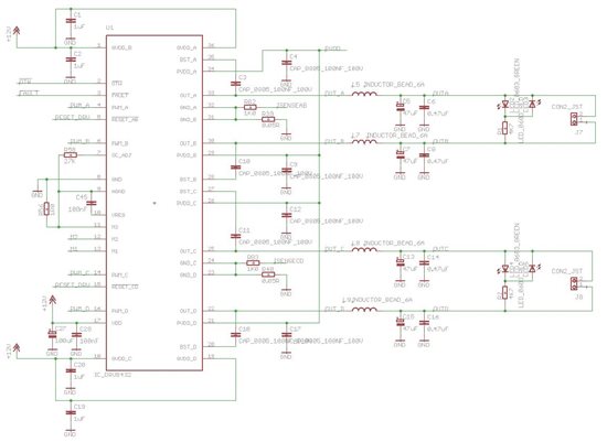

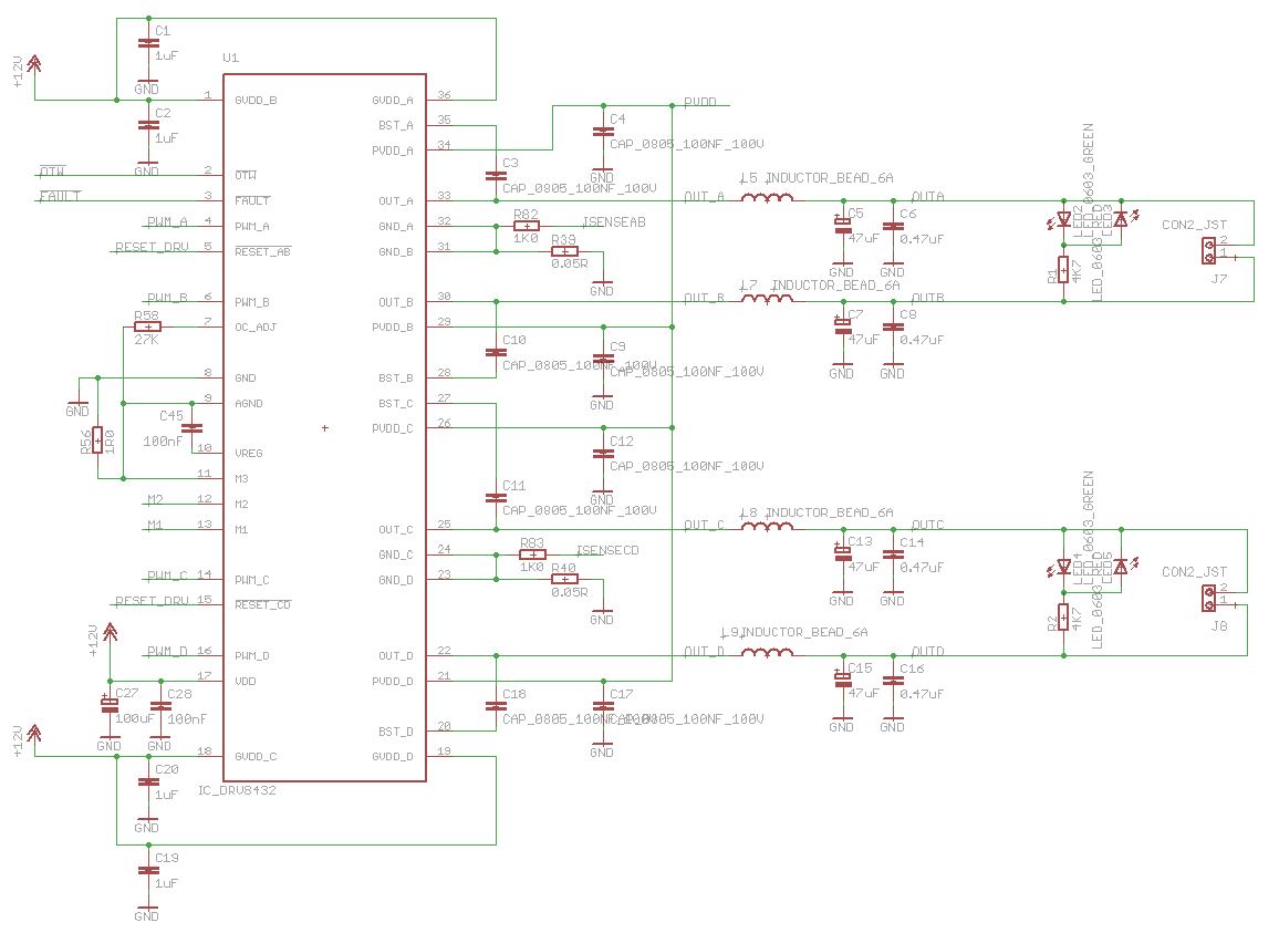

I have copied the EVM schematic and created a PCB to evaluate the DRV8432 in the absence of an evaluation board (below).

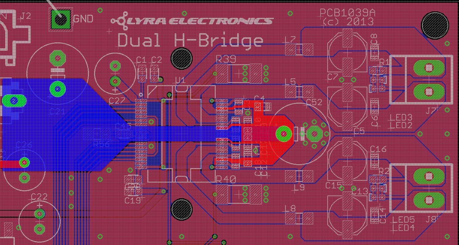

The layout of the PCB bears a striking similarity to the EVM board too (why re-invent the wheel?)

  • Mike,
    A few things that stand out or I am trying to understand. Do you have large decoupling caps on the GVDD and PVDD supplies? What is the purpose of R82/R83 to ISENSE lines? Are you intending to smooth the output with the capacitors (you are driving a DC motor correct)?
  • Hi Nicholas,
    Yes there are large (well, 470uF 50V) electrolytic capacitors, positioned in the same place as on the evaluation board. The PVDD cap is physically close to the middle of the "right" side of the IC.
    The capacitors on the motor outputs were to smooth them, as with the evaluation module, but I've tried the circuit without them too. The circuit behaves the same with or without them.
    R82 and R83 simply go to ADCs  of our controlling processor for monitoring purposes. I've just cut the tracks to these resistors at the 0.05R sense resistors and it has made no difference.
    The layout is attached too for reference. The highlighted section is PVDD.

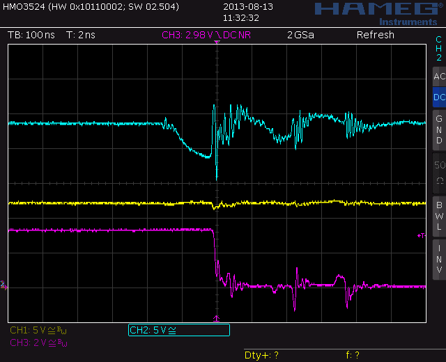

    Have you tried monitoring PVDD and GVDD on a scope as you apply the PWM signal? Possibly trigger on nFAULT and get a scope shot of PVDD and GVDD. You could also monitor the current with a probe to see if it is spiking when you send the signal. This sort of error seems to lead to some sort of undervoltage or overcurrent problem when you enable the Full Bridges.
  • Mike,
    Another note, in your layout it almost looks like pin 20 and 21 on the DRV8432 are shorting. This could possibly cause the issue you are seeing. Could you check this out.

    Try removing all of the capacitance after your inductor/bead.  If you look at the schematic in our EVM user guide, we list these as a stuff option for DC output.  If you are switching, you are most likely hitting an OC fault when charging these caps.
    http://www.ti.com/lit/ug/slou291a/slou291a.pdf
    Figure 3, page 6.
  • Thanks Nicholas - they are not shorting.
  • Thanks Ryan - they are not fitted on this board.

    This capture shows GVDD (CH1 yellow) and PVDD (CH2 white) against the fault line output (CH3 purple).
    What isn't shown is that the device is taken out of reset 200ns before the fault line activates, with a steady 10% 15kHz PWM signal being applied since power-up.
    The incoming PVDD supply does dip from 24V to 18V, but the 12V GVDD derived from this is pretty good I think.
    Is this PVDD dip enough to trigger a fault?
    Mike
  • Hi Mike,
    If I am reading the scope shot right it looks like there is about a 1V drop in GVDD right before nFAULT asserts This drop may actually be even worse if the GND is bouncing as well. Is this with no motor connected? That is pretty severe noise on PVDD.
  • There are no motors connected. I have just the inductors on the output lines, and a couple of contra-wired LEDs across the motor connector to indicate motor direction.
    Would you agree that PVDD must be being pulled down by the DRV8432 itself, as it doesn't go anywhere else (other than the 12V supply).
    It is possible that I have a faulty IC?
    This is the second one I've tried, so I'd be surprised if both are faulty.

  • I wonder if there's simply insufficient bulk capacitance on PVDD.  The EVM uses 1000uF, versus your 470uF.  With 10V of movement on the power rail shown in the waveform, I would try to make that stable first.
