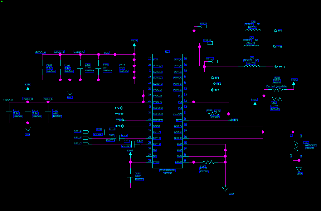

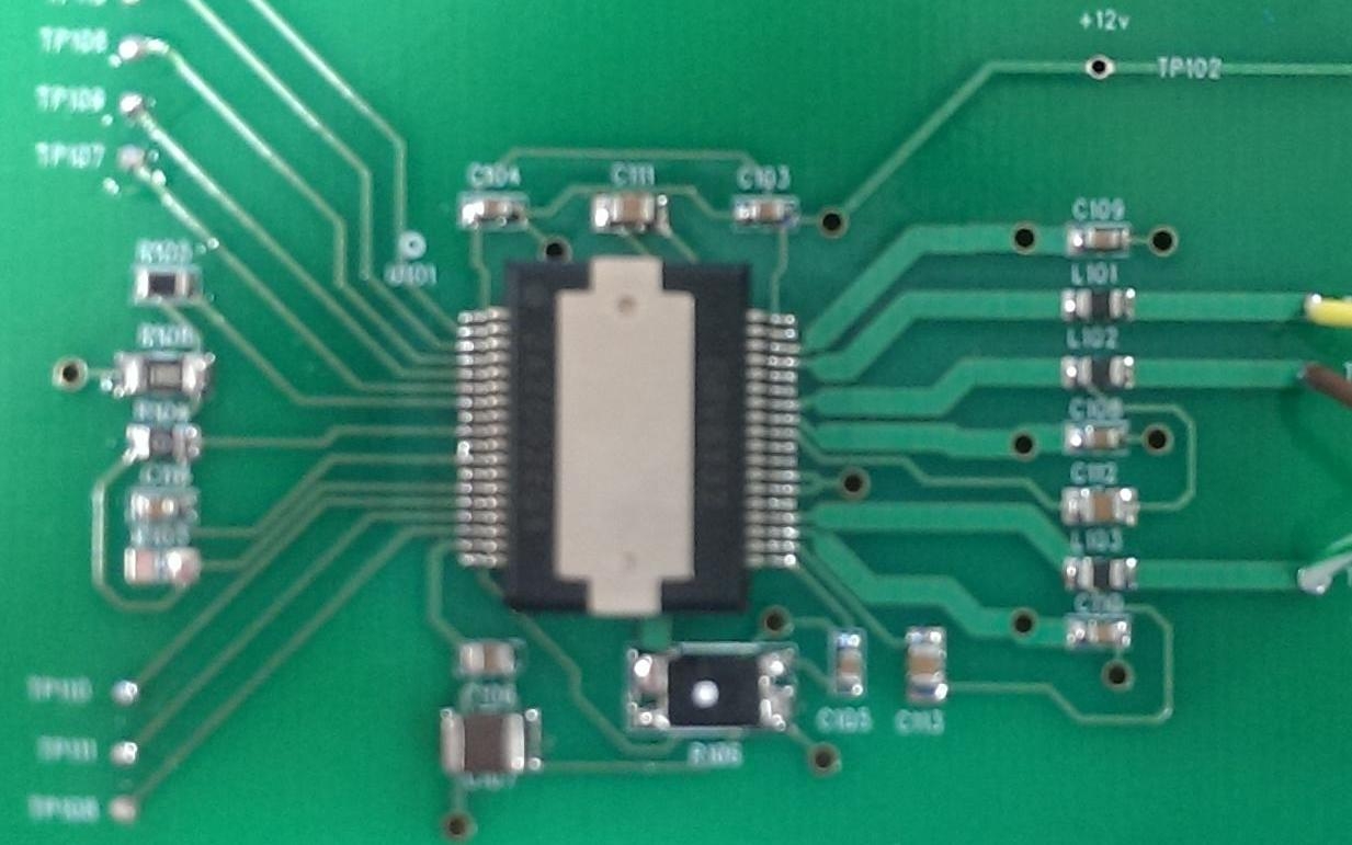

I have a custom PCB based on the design of the DRV8312-C2-Kit (with the 8332) being ran by a TMS320F28335. While my motor runs great unloaded at a constat speed, I keep shorting the chip while I try to start, stop or change the direction of the motor on the fly. Both my PVDD and GVDD supplies current limit, and I measure shorts between a bunch of the pins (bootstrap caps, PVDD to GVDD). I was wondering if this could be due to some back EMF or going over the absolute max ratings maybe (any of the -.3V ones, specifically).
I don't think it's a software issue, as I can run my code on the eval board without any problems. Do you guys happen to know any common causes of this type of failure? Are diodes recommended between the OUT_X and GND_X pins to maybe help with any negative voltage spikes? I can share my schematic, but I have done some mods on the board, so it would have to be fixed up first.

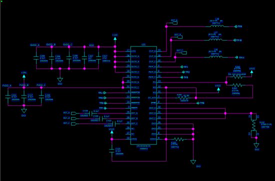

    See the attached schematic of the DRV8332. To ensure it wasn't a layout issue, I did a quick turn proto-board, following the recommended layout in the datasheet. I did see some improvement, but the chip is still failing while I try to increase the speed when lifting 5-7lbs through a 25-1 gear ratio. My supply is current limiting the chip to 4.5A, so I wouldn't think that would be the cause of the failure.
  • Hi Hale,

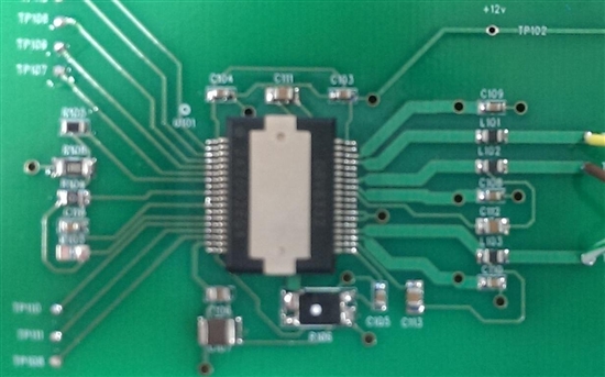

    I am not seeing the schematic, and can you also attach a snapshot of the layout around the DRV device.
  • Sorry, I edited my previous post to include the schematic. See snapshot below (sorry for the blurriness):

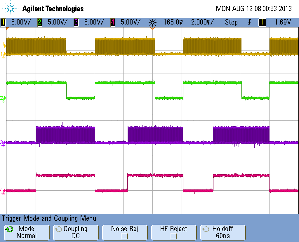

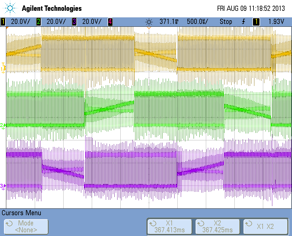

    Also see the DRV8332 input and output wave forms:
    Inputs:
    Yellow - PWM A
    Green - Reset A
    Purple - PWM B
    Pink - Reset B
    Outputs:
    Yellow - PWM A
    Green - PWM B
    Purple - PWM C
  • Hale, I understand your boards develop a short between PWR and GND after trying to use them.  Can you isolate which component is shorting?  Be sure to first disconnect your external power supply from the board, then measure the short at the power terminals, verify it's present with both probe polarities (so you know it's not a diode), and remove components until it goes away.
    What is your PVDD voltage, and the voltage rating of bypass capacitors?  It is good practice to use bypass caps that are rated 2-2.5x the rail voltage.
    In the blurry image, it almost looks like we can see a solder short between two pins on the left!  I suspect that's not the main issue though.
    RE
  • RE, after measuring, the only 3 caps that were NOT shorted were V_REG, BST_A and BST_C. The shorts on all of the remaining caps disappeared once the DRV8332 was removed.
    PVDD is at 28V, with the BST caps rated at 100V and all other bypass caps at 50V (I will bump them up to 100V to be safe).
    The short you see is intentional, it is between pins 10 & 11 (V_REG to M3).
    The chip usually gets damaged while trying to increase the duty cycle, do you believe it could be due to ground bounce? I am quickly accelerating the motor and then dead stopping it a few seconds later. Any other ideas?

  • Hale,
    When you say increase the duty cycle is this in steps (1%, 5%, 10%). Instantaneous changes can be very harsh on a BLDC system. I would not advise a dead stop.
    Also,

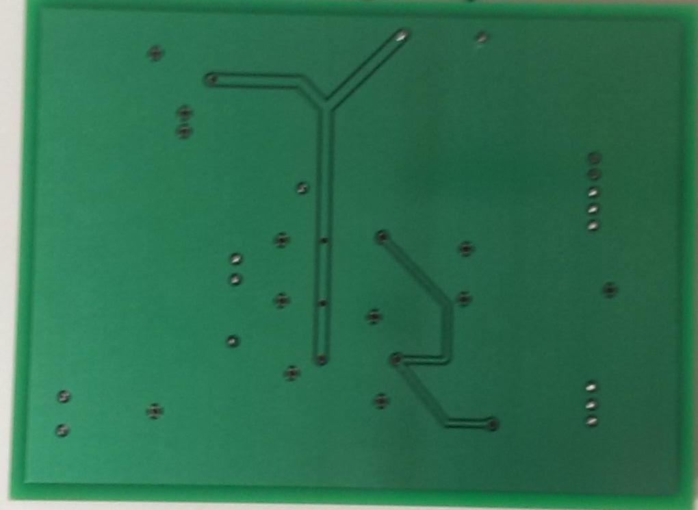

    I do not see a GND plane on the top layer. Is this on the bottom layer? What does it look like?
  • Hi Hale,
    I noted that the bulk capacitor for PVDD is missing on your schematic and board. On the DRV8312-C2-KIT schematic, there are 2 470uF bulk caps at the PVDDIN terminals (see the upper left side of page 3 of the schematic). Without a large bulk capacitor, the problem that you are seeing is very possible.
    Please add a bulk cap of at least 470uF across the PVDD to GND on your board. If that does not correct the problem, can you send the layout and current schematic in its native program. We have access to many viewers.
    Thanks.
  • Nick,
    Yes, I may be changing it a little too instantaneously and therefore possibly exceeding some max rating. Let me replace the chip and try changing it in smaller steps, I'll let you know how it behaves.
    Also, here is the back of my proto-board; it is one ground plane with the +28V (thick trace) and +12V (thin trace).
  • Rick,
    I added a 680uF 63V cap to the PVDD input. I am also accelerating and decelerating by ~10% duty cycle while starting and stopping. So far it seems to behaving better. I have two questions though:
