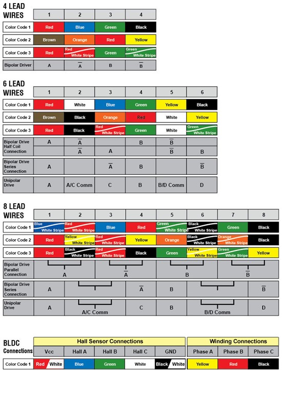

    The step motor has 8 wires, and 4 pairs, each pairs connect to OUTA, B, C, D. And the manual shows the same. I am not sure you are talking about other kits. But the kits we ordered has a step motor come with 8 wires, and the manual indicate so. all this wires are color coded, and I connect to the board based on the instruction from the manual.

    Can I see this manual and data sheet for this motor? Does this motor have 4 windings then? As I mentioned, standard bipolar stepper motors have 2 pairs (2 windings), I am staring at one as I type this.

  • Thanks for the file Weibin, this clarifys some things.
    The board you have is actually one revision back of the latest board I believe. We no longer ship motors with the new revision. In general Bipolar steppers have 4 wires, one wire on each side of the winding.
    There are some variations on this, which includes the one you have. See the picture attached.
    In a 4 wire stepper motor you just have connections to 1,4,5, and 8. The middle two pins are tied together internally.
    So back to your original question. 1 winding is between pins 1 and 4, the other is between 5 and 8.
    Or from the board, OUTA and OUTB drive one winding, OUTC and OUTD drive the other. You can refer to the image below for more details on the various configurations.
