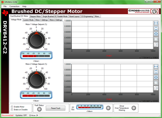

I got my computer to connect to the DRV8412 board but the Fault button stays red. Reset won't turn it off.
Do I need to Re-Flash the card and, if so, how do I do this?

  • All LEDs (6) are on. Red is flashing on Control Card.
    Using DVR8412EVM Rev G
    GUI Rev G (I think).
    DC Bus voltage 19.2
    Not sure how to re-flash.

  • Hi Bruce,
    Thanks for the info. Now that we know the version of the EVM is rev G, we can confirm that the GUI is also rev G. When the GUI is started, it should indicate that DRV8412GUIv9 is starting. The v9 GUI is designed to run with the revG EVM.
    Are you using the 24V power supplied with the kit? If so, there appears to be a problem with your bus voltage. The GUI is reporting 19.2, but should be 24V. What voltage do you have at the DC Bus connection? Do you have 12V connected to the +12V Control Power? Is JP1 connected to VR1 or +12V? What is the voltage at JP1,pin 2 (the jumper should be in place)?

  • Well, for some reason the engine shut down and I was able to restart the GUI and made a successful connection to the control card (GUI said 'connected' at the bottom left). So now I am back to where I was 3 days ago. I can only get v2 to run, not v9.
    There is a Red Fault Button on the GUI, the Bus Voltage is 19.2 and the High/Low Voltage Button is GRAY (not Yellow or Green or Red). The Red LED on the control board is flashing again (When it was not flashing, the engine could not connect to the board).
    One last note...The Quick Users Guide says, in the Hardware Setup, SW3 should be in the UP(off) position. One of the TI dudes says that SW3 should be in the DOWN (on) position. I now have set it to Down but nothing seems to have changed.

  • I flashed the v9 data, the blinking red LED on the control board went off. But v9.exe still won't execute.
    Bruce
  • Oh the sweet sound of a stepper. Finally:)
    I still cannot get GUIv9 to work on my machine but v2 Does Work!! So, using your last set of instructions I UNIFLASHed for v2. That seems to have done the trick. Thank you all for helping me through this. You guys are great.
    Now for the next problem. I need the motor to go +/- in a sinusoidal fashion. The Quick start guide shows some sinusoidal activity but I don't see how they did that. I'll play around some more and maybe figure it out.
