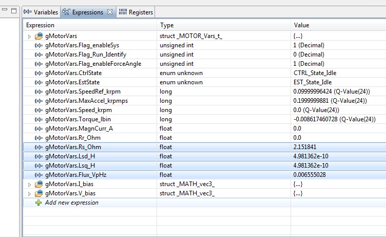

I'm using DRV8312 & TMS320F28069 same like DRV8312 kit for driving BLDC motor.
Everything look fine , I did check Amp output it seems OK. Same ref V with evaluation board and I can see it works if I load more on BLDC motor.
But the problem is I can't get profile though CCS debuger. Evaluation board works fine but my board. And my board has stable problem that the RPM is not really stable and I have to force to spin with my hand first.
Please help me What is the tuning point. opamp? Artwork? passive value? ADC lowpass? or other thing?

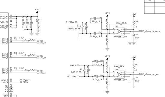

------------Schimetic---------
# C24, C25, C12, C13 is not populated.

    For the board problem have you checked the voltage outputs at I_TOTAL and IC_FB with no current? This will confirm that the voltages are correct at the start.

    What changes did you make vs. the EVM board to the current and voltage sensing?

  • I have only one problem. The result of it, I can't get motor parameters I think.
    I_TOTAL and IC_FB.... is all same about 1.7V.
    * Evaluation board works fine motor driving and get a parameters of my motor.
    * I use 'MoterWare , proj_lab02a ' same software as EV board. (pin connection is same)
    * I use XDS560V2 , JTAG
    Not suppose to like 4.981362e-10
  • something appears wrong with your Ic shunt current measurement, and likely the whole circuit.
    you may be able to set the number of current sensors in user.h to (2) so it will only use Ia and Ib. If these circuits are good it may work and let you debug the problem, but I suspect there is a larger hardware issue with the inverter/sense circuitry.
