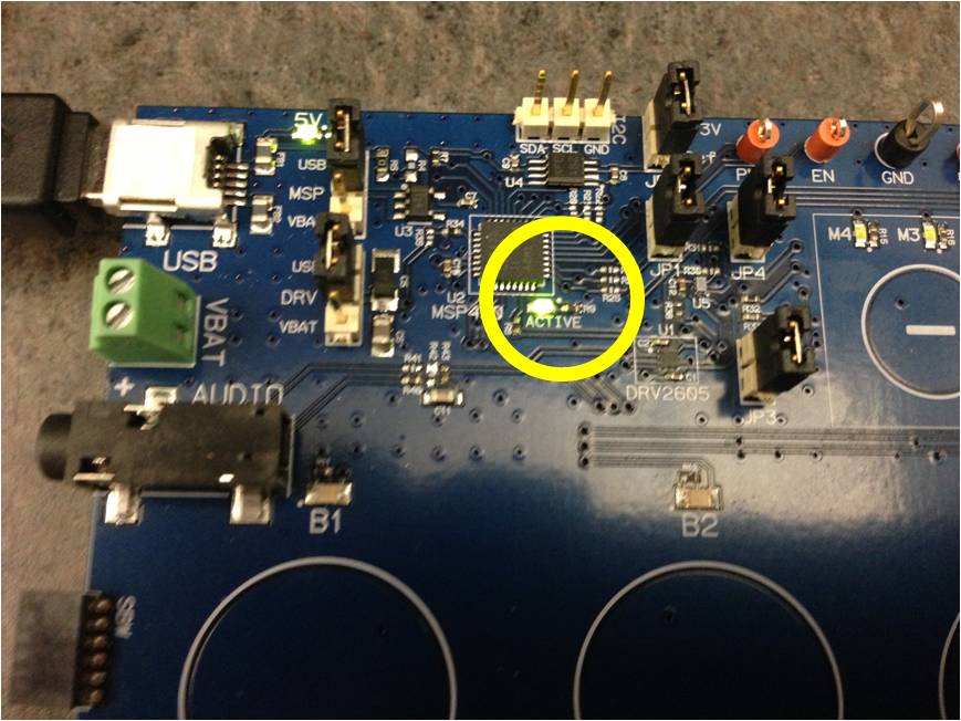

I'm struggling to control the DRV2605 via the I2C. I'm using the evaluation board and I'm interfacing with an arduino.
I have been following the steps very closely but I can't get the device to playback anything. I have initialized, calibrated (generated activity on the actuator), saved the calibrations, loaded a waveform into 0x04 set 0x0C but nothing. On the evaluation board I have followed the instructions to set external I2c input mode.
I wondered if anyone was able to look at my arduino sketch to see where I'm going wrong:
