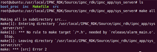

I was trying to compile the Sys_server. but the error occoured when I was compiling the Sys_server in the RDK5.1.
the erroe is as below:
root@ubuntu:/usr/local/IPNC_RDK/Source/ipnc_rdk/ipnc_app/sys_server# ls
boot_proc inc Makefile src
root@ubuntu:/usr/local/IPNC_RDK/Source/ipnc_rdk/ipnc_app/sys_server# make
Making all in subdirectory src...
make[1]: Entering directory `/usr/local/IPNC_RDK/Source/ipnc_rdk/ipnc_app/sys_server/src'
make[1]: *** No rule to make target `/*.h', needed by `release/alarm_main.o'. Stop.
make[1]: Leaving directory `/usr/local/IPNC_RDK/Source/ipnc_rdk/ipnc_app/sys_server/src'
make: *** [src] Error 2
I was stuck on this error for a long time . pls give some tips on how to solve this problem. your prompt answers will be highly appreciated . thank you!!!!!
Scott, I have no idea what sys_server is. It has nothing to do with
DRV8301-HC-C2-KIT(F28069M) firmware
IPNC_RDK appears to be something to do with a Davinci / DSP processor?
