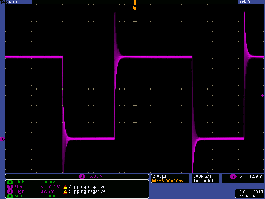

Hello, I am using the DRV8432 in my design, and I am getting a lot of ringing on the output at the solenoids, and motors that I am controlling. I have followed the recommended design that was given by TI, and I am curious to see if you have experienced this before. On the eval board there are inductors on the outputs of the driver. Can you tell me what they are used for? It seems that when I remove those inductors I still get some ringing, but it is much less. Below is a schematic of the circuit and the output of the driver at the load.

  • Hi Rob,
    The inductors on the EVM are used to allow paralleling the outputs. If you are not running the outputs in mode 3 (parallel), they are not required.
    I have seen ringing before, but not at this magnitude. I did not see a bulk capacitor on your schematic. Did I miss it? If there is no bulk, please place a large capacitor across PVDD and GND. A good start would be 2uF/W.
    Let us know if this helps.
  • Rob,
    Snnuber circuit i.e. combination of series capacitor (typically 0.1uF) and resistors (10 to 10ohm) across each outputs and GND should also help in reduce the ringing.
    Best Regards
    Milan -Motor Application Team
  • Thank you Rick and Milan, after removing the inductor a lot of the ringing was removed. The snubber is a good idea as well. I will add it to the output. Rick, I do have a bulk cap on PVDD that is not shown on this schematic. It is located at the power connector similar to the 1000uf C1 that is on the eval board. We will try a few more things here, but it looks like removing the inductors from the board will make the biggest improvement, and the rest we should be able to filter out with the snubber and diode array.

  • Hi Rick and Milan, I went back to have a look at the waveform on the DRV8432EVM Board, and I see the same noise at the same frequency of about 111.111MHz. With my PVDD set to 24V this is giving me a ripple with an amplitude of 7.4V. Below is a screen capture of the ripple I am seeing on the rising pulse. The same ripple is present on the falling edge of the output PWM from the DRV8432. Any thoughts on getting rid of this?

  • Hi Rob,
    Last time, you mentioned that you planned to add a snubber. Have you done so, and what values did you use?
    While not exactly the same because the FETs are external and the application is a buck converter, the application note on the NexFET provides insight on the problem and how to correct it. The link to the app note is:
    http://www.ti.com/general/docs/lit/getliterature.tsp?baseLiteratureNumber=slpa010
    For reference, I found this by searching the TI site for "snubber application note".
    The app note requests one piece of information that is not provided in the DRV8432 datasheet. I will get back with you once I have the estimated Cp.
  • Hi Rick, I have tried several different snubbers and the one that worked the best had R = 15ohms, and C = 10uF. The problem with this is the power dissipated through the resister is huge! (Almost 4W) That configuration reduced the amplitude of the ringing, but not enough. I will take a look at the app note now.

  • Hi Rob,
    I got the information. The typical value  for the DRV8432 is 250pF.

  • Hello Rick,
    We're having the same ringing issue in our design.  We added the inductors at the outputs as short circuit protection, but due to the large ringing our motor current measurements show large spikes.  When we tested our boards after removing the inductors, the ringing peak to peak voltage reduced from 57V to 36V.  Per your response to Robert, the inductors are not required if the outputs not running in parallel mode.  We're considering to remove the inductors from our boards since we're running two motors in dual full bridge mode.  Could you please let me know if it would be OK to do that without any other consequences?
  • Hi Rainbow,
    The inductors are not required, but are recommended if you desire to protect the outputs against possible short circuits to high current signals (PVDD, GND).
    Please note section 7.3.2.2 of the datasheet. This section contains a recommendation to limit the current by adding a ferrite bead or inductor to protect the output pin against a short to power or gnd.

  • Hi Rick,
    I added a snubber consisting of a 10 OHM resistor and a 0.1 uF capacitor between PVDD and GND. But, I didn't see any ripple reduction from the DRV8432 output voltage. But, adding the snubber in paralled across a motor which is run by the output voltages reduced the output ripple voltage from 3V to 1V.
