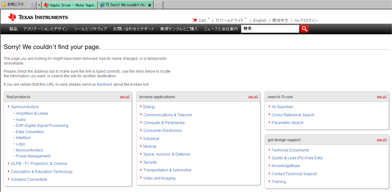

  • Thank you Mr. Gautham,
    I went to the DRV2605 product page.
    And I clicked link of "Request Full Datasheet" .
    But I can not get it.
    Linked web page was written as follows.
    "The page you are looking for might have been removed, had its name changed, or is temporarily unavailable.
    Please check the address bar to make sure the link is typed correctly, use the links below to locate the information you want, or search the site for another destination.
    If you are certain that this URL is valid, please send us feedback about the broken link. "
    Please help.

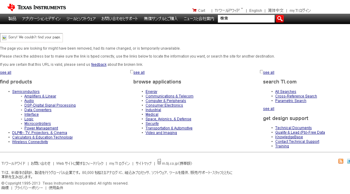

  • Hello Mr.Gautham. Thank you for your kindly support. But still I can not get full data sheet. Your instructed address was not work. Does It related our company's internal security system? I will try again by my private connection.
    Regards, gnanoe.
  • Hello Mr.Gautam,
    I am appreciated to your support.
    I tried your instructed address by my home.
    But result was same.
    I could not get Full datasheet.
    Can I get Full datasheet by E-mail?
    I must overcome this issue ASAP.
    gnanoe
