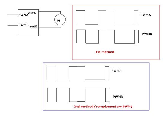

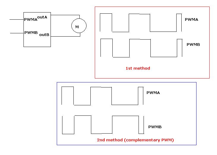

I want to control the direction of a DC motor using the DRV8432. To do this how should I give the PWM signals?
Is it using the method in the picture?  OR is it to go forward change duty cycle of A with and set duty cycle of B to 0 AND backward by changing duty of B and setting duty of A to 0.
OR is it something else?
EDIT-I have set M1,M2,M3 to 0
This is quite urgent so please reply soon

    I would recommended to use slow decay PWM driving method. Please refer to the below configs.
    1. forward:
    PWM_A : min % to 99 % to control the speed. min means the lowest effective duty, should >1%.
    PWM_B : 1% constant. (the 1% is to give a pulse to keep the cycle by cycle (CBC) current limit function.)
    2. Reverse:
    PWM_A : 1%
    PWM_B : min % to 99 %
    3. Stop or Breaking:
    PWM_A: 1%
    PWM_B: 1%
    (if your motor current will never meet your CBC trip point at startup or stall condition. you can go 0% for all the 1% listed above)
    Your'd better not use complementary PWM for direction control. That will cause waste current at 50% duty for stop.
    Thanks.
    Wilson
    Motor Application Team
