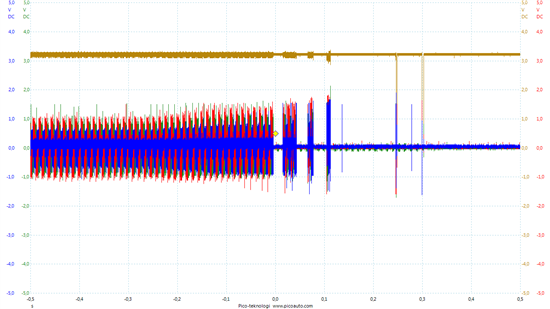

We’re using DRV8332 drivers to drive several BLDC in our system. On one of the axes we experience strange driver behavior when trying to accelerate past a certain speed.
The first figure below shows the three phase current measurements along with the FAULTn signal (brown). The motor spins with 4900 rpm before the acceleration starts at around -0.3 s in the figure. As you can see the driver shuts the output down at 0 s, but without signaling any fault condition.
Since the motor continues to spin it will continue to commutate and seemingly resume drive. Because of high gain the controller will have increased the duty cycle so the driver soon shuts down again. But FAULTn is not asserted until around 0,25 s.

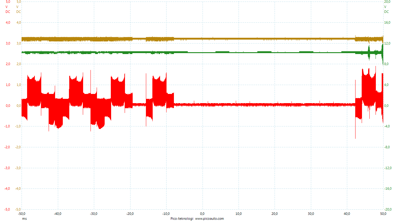

Another test run is seen in the figure below. It shows one phase current (red) zoomed in. It seems like the phase is shut down (at -20 ms) for 120 degrees during its Low Side ON state, still no fault condition (brown).
We use trapezoidal control according to the TI DRV8312EVM sensored example code (hard chop). The driver is set to Over Current Latching mode.
My question is, why does the driver shut down? And why doesn’t it signal any fault condition?

    Could you also give the partly schematic for DRV8332? also it is not easy to find out the current level on your waveform, could you help to give something like 1V = ?A, also your mode setting and current limit settings?
    is your device get hot at the issue time?

    The design follows the TI reference design: 1602.servo.pdf. The current plots are offset by -1,65 V and the relation should be 5,2A/1V.
    The driver is set to OC latching mode and the OC adjustment resistor is set to 30kOhm.
    The device doesn't get hot.
    Johan
    We have determined that the shutdown was due to insufficient bootstrapping. The voltage was to low to open the high side switch at the commutation point where going from phase off to phase driving.
    We solved it by manually opening the low side switch a few cycles before opening the high side.
