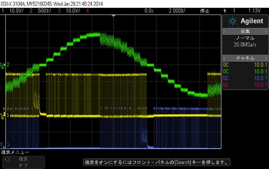

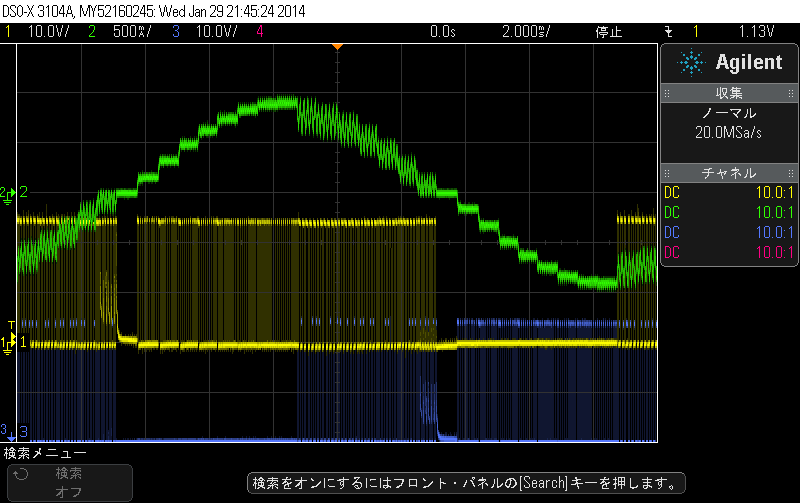

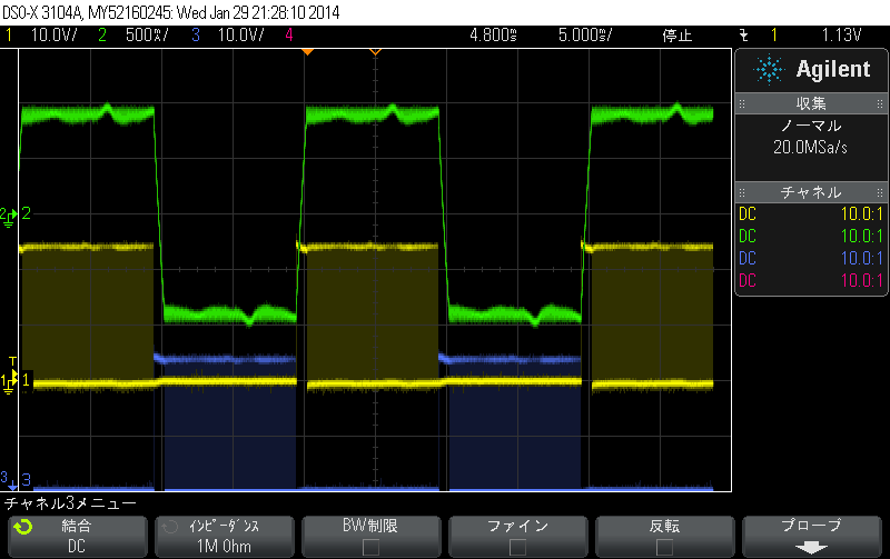

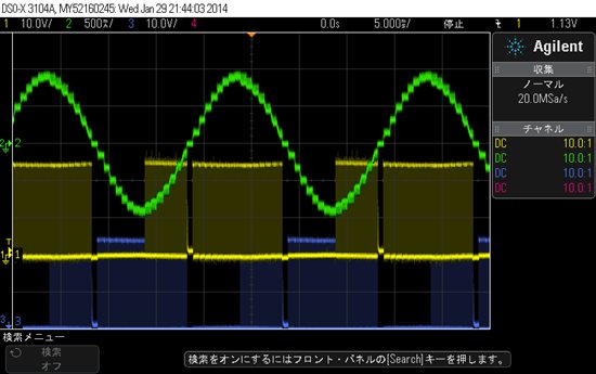

    DRV8818EVM was borrowed and evaluated to the customer.
    The motor used 103H5205-5254 of SANYO.
    (There are 24V, 1A, 1.8°Step, and not a datasheet)
    A result is written to below.
    The measured waveform is attached.
    (ch1:VAOUT1, ch2:IAOUT1, ch3:VAOUT2)
    - The waveform of a full step
    Even if it changes Decay, change is nothing to a waveform.
    - The waveform of 1/8 step
    * It is 0.6V (Fast Decay) about Vref of Decay.
    * It is 1.6V (Mixed Decay) about Vref of Decay.
    The noise to which Vref resembled the time of Fast Decay in at least 1.2V occurred.
    * It is 2.0V (Slow Decay) about Vref of Decay.

    Although 1/2Step, and 1/4Step were not about 1/8, either, it became the current waveform similar at the time of Slow Decay.
    [Guess]
    I think that, as for Fast Decay, the noise influenced, as for Slow Decay, speed of response influenced, and the current waveform collapsed.
    [An additional question]
    Only as for Vref:1.6V, Mixed Decay at the time of 1/8Step was stabilized.
    For example, is it set to Mixed Decay of operation near Slow Decay at the time of Vref:1.9V?
    Vref: Is it set to Mixed Decay of operation near Fast Decay at the time of 1.0V?
    Does Mixed Decay change operation by Vref (0.7V~2.0V)?
