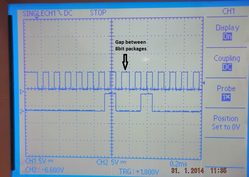

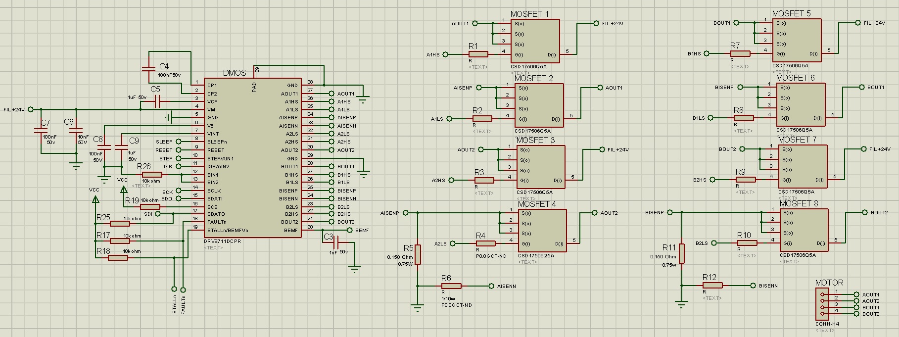

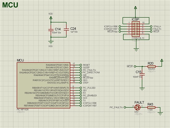

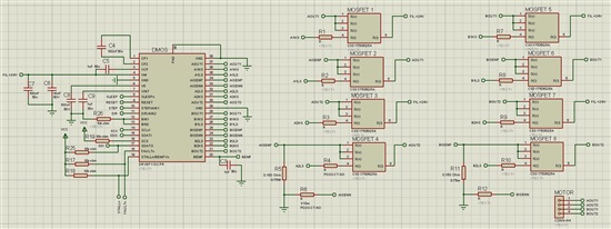

  • Thank you for quick reply.
    1) There is a 10k pull up on SDATO. You can find the schematics of the PCB below. I think MCU is sending the correct waveform. I am sending the scope shot as attachment. These are the scope shots of the same signal with different zoom levels.
    2) The voltage on SCS is 4.5V.
    3) System have only one SPI slave (drv8711). Is resetting drv8711 clear any out-of-sync transaction? I am resetting the drv8711 before transaction and then send the data.

  • Hi Erhan,
    Thank you for the details. From the screenshots, it appears that the DRV8711 is communicating with the mcu.
    According to the datasheet, issuing a reset will clear the SPI interface and re-synchronize it.
    We will attempt to read on our side using the same procedure that you have performed. Can you confirm that this is the first read of the DRV8711? Is nSLEEP a logic high or low? If RESET was issued, was it issued while nSLEEP was a logic low?
    Looking through the schematic, I noticed a couple of items that should be addressed:
    1) Do you have bulk capacitance on VM? Please examine the DRV8711EVM for examples, but there is usually a 100uF bulk on the board, plus a 10uF and .1uF ceramic near VM. At the DRV8711EVM folder, scroll down to the Software line. The zipped file contains the schematic, layout, and firmware used for the EVM.
    2) Please note that the xISENSx circuitry has been modified. Page 16 of the datasheet now recommends that either no resistors or two symmetrical resistors are used in the. In your case, it is recommended that the resistor is zero.
    I will have a further update soon.
  • Hi Rick,
    The initial state of the clock pin is low. The pin is set to high when I set the SPI parameters inside the code. Therefore, initial state change may result in a synchronization problem. But I reset the DRV8711 before SPI communication and according to datasheet this should re-synchronize the communication.
    I tried to write CTRL register with and without a RESET while nSLEEP is low and nSLEEP is high but nothing has changed. I tried to read CTRL register by sending (1000 0000 0000 0000) but the SDATO pin is high and there is no signal during the spi clock, DRV8711 is not responding to read operation. SCS pin is 4.5V. I checked the VM pin of the DRV8711, it is +24V. All the pin connections between MCU and DRV8711 is double checked. Stall and fault pins are high. I also changed the PCB and perform the same tests in case of any damage to the previous board.
    1) I sent only a part of the schematic. There is also a power-line that contains varistor, TVS, two 100nf 100V ceramic cap (used to support varistor and TVS), one 220uf 50V bulk electrolytic capacitor and a 10uf 50V ceramic capacitor. The power-line is connected to the VM through 100nf 50v and 10nf 50v ceramic capacitors near VM pin.
    2) In the schematic, all the resistors connected to the xISENSx pins (which are denoted as R ) is zero ohm resistors.
    Thank you for your help.

  • Hi Rick,
    I solved the problem by connecting the chip select pin to the MCU via an external cable and now everything is working fine. The problem seems to be out-of-sync of communication. I think the initial state change of the clock-pin is the reason of the problem and the RESET pin doesn't initialize the communication as it is written in the datasheet but I am not certain about that, it should be double checked. As a result, pulling up the chip select pin is a very bad idea and it cost me more than 3 days :)).
    Erhan
