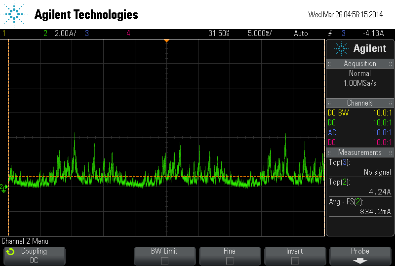

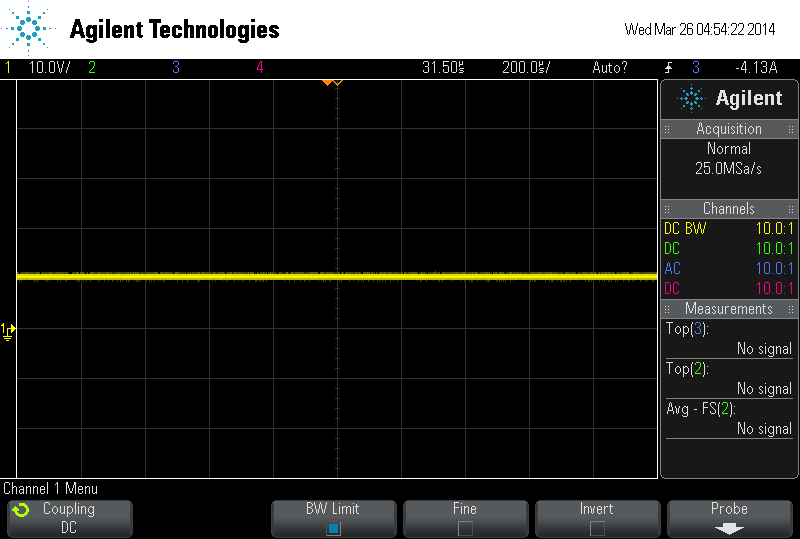

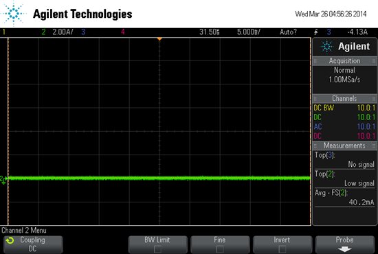

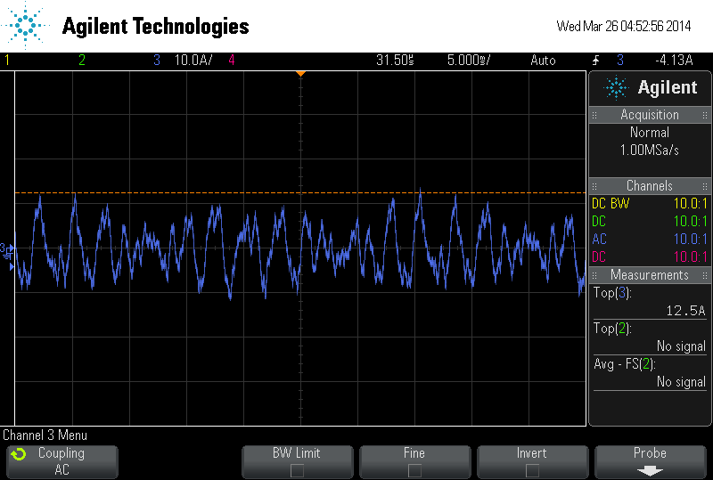

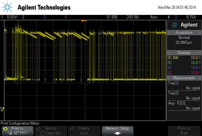

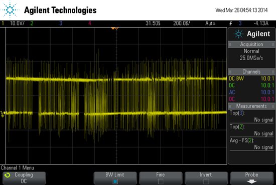

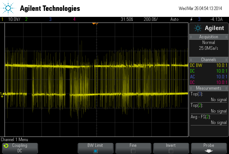

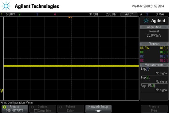

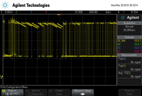

  • Hi Rick,
    My coil (L=470 uH and R = 0.4 ohm) is connected between 1- and 1+ of the connector.
    Attaching screenshots:
    1. BST signal just before shutdown.
    2.BST signal after shutdown.
    3. Output current just before.
    4. Output current just after.
    5. Output voltage just before
    6. Output voltage just after (~= GVDD voltage)
    7. Current from supply to main input capacitor jon PVDD just before.
    8. Current from supply to main input capacitor on PVDD just after.
    Didn't provide GVDD voltage since it was rock steady at 12V, both, before and after the shutdown.
    Rohit
  • Hi Rohit,
    It may be that the BST undervoltage protection is affecting your operation still. In screen capture 1, the BST signal is drooping approximately 3V. This is the danger area where the device can turn off the outputs.
    Please add a larger capacitor on your BST pins and look for improvements. See the page 11 of the datasheet for recommendations (220nF is recommended if you do not have a 5 Ohm resistor in series with the GVDD_x pins). If this does improve the performance, add a 5 Ohm  in series with the GVDD_x pins and increase the 220nF to 1uF.
  • HI Rick,
    Sorry for the late reply. I can't see the BST signal dropping below 10V. I believe you may have not seen the the ground reference point. It is about 2 units below the lowest point of the signal. That is about 10V.
    Rohit
  • Hi Rohit,
    You are correct that BST does not drop below 10V with respect to GND. However, BST does drop below 10V with respect to the OUT_x pin. This is also being monitored.
    If the OUT_x is set high for too long and BST-x minus OUT_x drops below approximately 10V, the outputs will be disabled. This circuit (BST_UVP) is to protect the high side FET. See page 11 (Bootstrap Capacitor Under Voltage Protection) for more details.
