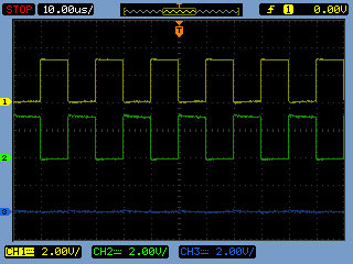

  • Lee,
    What is your applied PWM signal pattern? To get zero ouput voltage/current at 50% duty cycle, you must apply inverted or complimentary PWM to two active legs of H-bridge, while in the un-energied leg both switches should be off by resettting.
    It would be if you can show Input/ output PWM waveforms scope-shots from actual set-up to better understand the issue.

  • Milan
    Thanks for your reply.
    I attached the schematic and scope-shot.
    The following is input/output pwm scope shots. I input 50% duty ratio pwm signal to PWM_A pin of drv8332 and input a inverted signal to PWM_B pin of it. PWM_C pin is reset.
    CH1: PWM_A, CH2: PWM_B, CH3: PWM_C

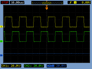

    The following screen shot is driver's output for above input conditions.
    I don't know why the output is not zero.
    CH1: OUT_A, CH2: OUT_B, CH3: OUT_C

  • Lee,
    Everything is working perfectly fine and DRV8332 outputs are as expected.
    You see in switching H-bridge, the notion of zero voltage is meant for average voltage over a PWM switching cycle. It not meant for instantaneous voltage. The average differential voltage applied across OUT_A and OUT_B is zero in your second scope capture.  For 50% of time, OUT_A high, OUT_B is low so differential voltage OUTAB is +12V and remaining 50% of time, OUT_A low and OUT_B is high so differential voltage OUTAB is -12V, effectively over as PWM cycle average voltage is zero.
    I hope above explanation clarifies your doubts. Let me know if you need further clarification.
