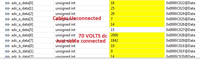

I am using TMS 320F28335 to control PMSM. I am facing ADC problem because when I connect ADC cable to ADC automatically reads the values round about 1820. When I activate the filter, it reads zero but then whatever analogue while I input, digital output remains almost zero i mean round about 20,30.
As in the figure below ADC without filter with just cable connected and no analogue input reads 1842, with 70 volts DC input it reads 2000 and rest of the values shown are all other ADCs without cables connected. I have selected internal voltage reference for ADC and the TMS320F28335 board is custom made.
How can I make ADC to read 0 at no analogue input and then increase digital value accordingly.
