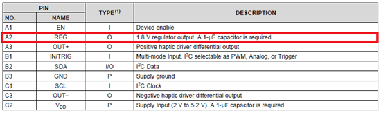

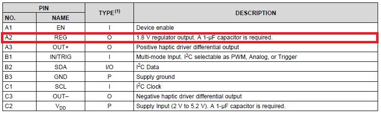

I found following description in DRV2604L datasheet P.3.
It seems that DRV2604L recommends 1.0uF for VREG capacitor.

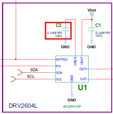

On the other hand, DRV2604L EVM adopt 0.1uF for VREG capacitor.
Can 0.1uF be used for DRV2604L VREG capacitor?
I think 0.1uF can be used for DRV2604 but DRV2604L needs 1.0uF.
