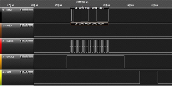

  • Hi Wilson,
    Please see waveform below. Do you see any problem in my code?
    Do I need to write the current limitation bits at the beginning of runtime before I send general motor control commands or can the configuration bits be set at the same time when I send general motor control bits during loop?
    Loic

  • Hi Loic
    Could you try SSTB = HIGH all the time?
    Thanks & Regards
  • Hi Wilson,
    I tried SSTB = HIGH all the time but unfortunately no luck... Still stick at 300mA...
    Loic
