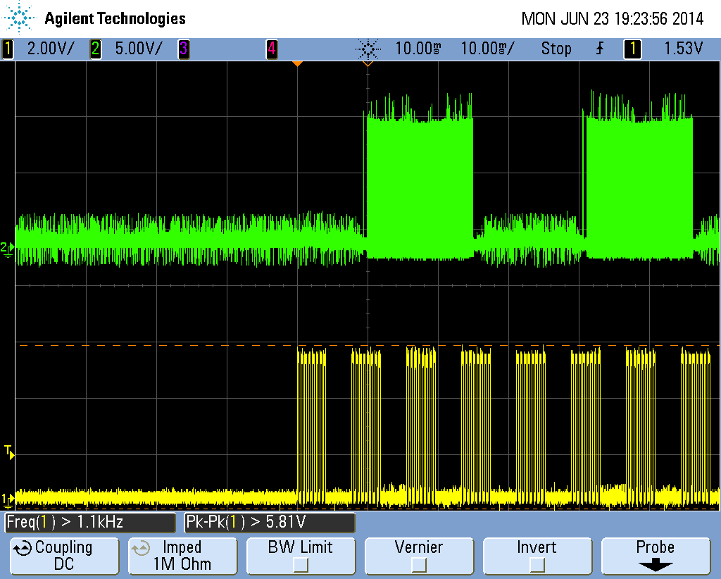

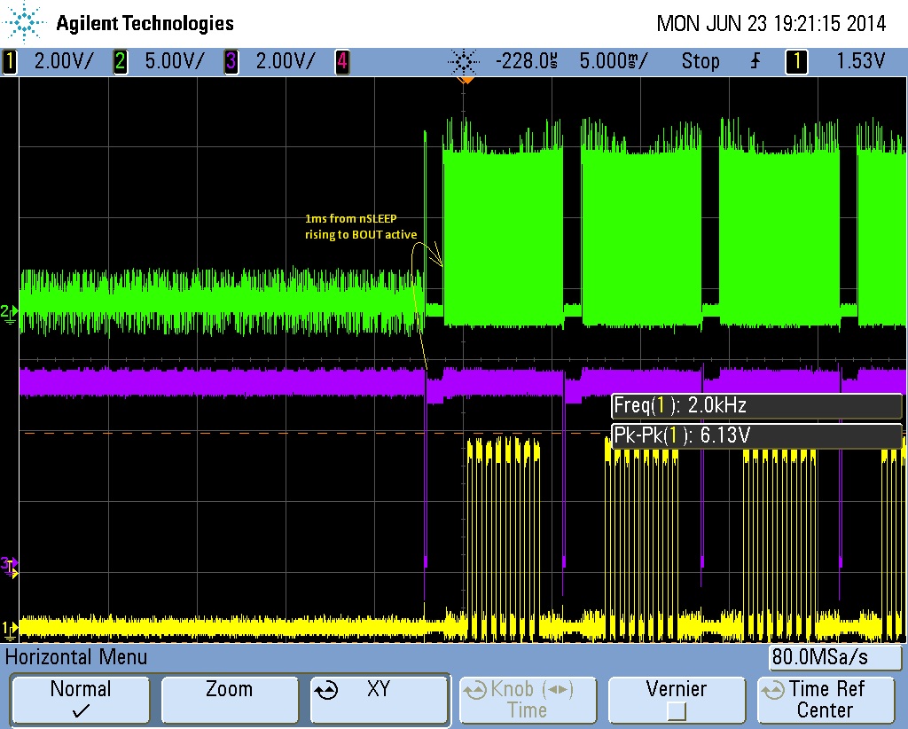

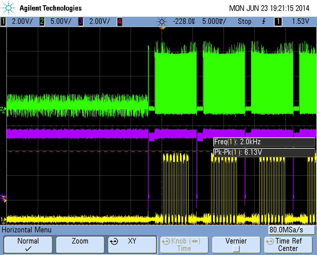

    I have two set of scope captures.
    One where I put the driver to sleep between each step. You see the sleep command on the purple line.
    And the next one where I have no sleep command. (The motor seems to run fine)
    The other signals are Yellow; step command (micro step) and Green; Bout1
    Does this make any sens to You?

    Would you please send the motor specifications? Using 4 and 8 full steps between nSLEEP may be too fast for the motor to accelerate. Some motor manufacturers have specs such as Self start range or start/stop region, which designates the area that the motor can start/stop or change directions without using an acceleration profile.
    With the information provided, the controller appears to wake up properly. After 1ms, the output BOUT1 is being driven. Please capture the other outputs to make certain they are also being driven. If you have a current probe, please capture the currents.
    I have highlighted the time from the nSLEEP rising to the output driving below.
