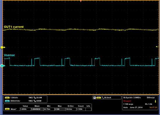

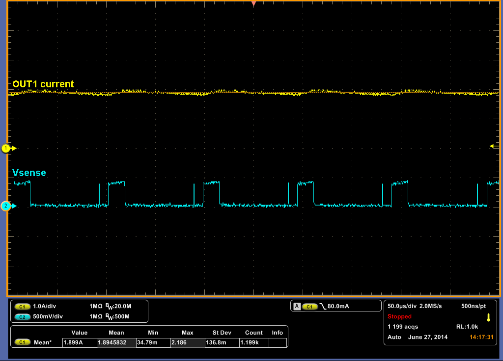

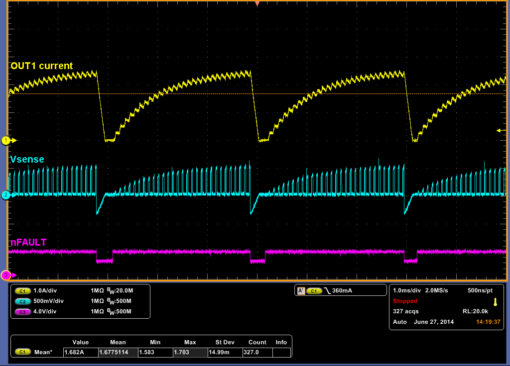

  • I took some bench measurements and confirmed that VTRP (the sense voltage trip) is indeed 500mV as the datasheet states.  These waveforms used a 0.2ohm sense resistor.
    You are correct that nFAULT goes Low when the sense voltage exceeds VTRP.  I suspected otherwise since the datasheet text doesn't mention that and most of our other devices don't behave that way.  I'm aware of Page 7, but "SENSE" there is vague, and the other acronyms "STB" and "STG" aren't defined anywhere else.  I'll add this to our list of improvements to make.
