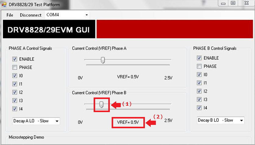

  • Hi Wilson-san,
    My customer also pointed out the following.
    In "Current Control(VREF) Phase B " of GUI,  it seems that the value of (2) is inconsistent with (1), and (2) indicate incorrect value.
    I heard "Current Control(VREF) Phase A " is OK.
    Is it just a improper indication of GUI?
    Yaita

  • Hi Wilson-san,
    In addition, it seems "Current Control (VREF) Phase x" slider doesn't have effect on actual VREF voltage of EVM.
    Does your EVM operate well?
    Yaita
  • Hi Yaita
    I checked the both the slider A and B are working correctly.
    But we should pay attention to our test about the upper side (PHASE and Curent Control function) and the bottom side (Microstepping Demo function) of the GUI.
    Usually we test the upper side function first. We can check the ENABLE, PHASE, Ix and Decay. Note that the VREF slider control the DAC outputs to the VREFx pins (you can check the voltage with simply a multimeter). Note that the real current will depend on the Ix, decay setting and the VREFx.
    Once we start the Microsteppering Demo control, all the ENABLE, PHASE, (Ix are exclude), Decay, VREFx are taken over by the DAC-VREFx-PHASE micro-stepping algorithm. In this algorithm (Please refer to http://www.ti.com/lit/an/slva443/slva443.pdf ), VREFx are fed with fixed range sinewave voltage from the DAC. When the motor is running and controlled by the bottom side GUI function, any change on the upper side will still affect the outputs (I should correct my last saying that they are independently). Some parameters are continously updating in the micro-stepping algorithm, such as the VREFx voltage and PHASE and DECAY, so your mannully change on the slider in upper GUI will only take a transient effect because it will be override soon. But some IO can disturb the microstepping totally, such as ENABLE and Ix.
    We are sorry that these mixed effects of upper side and bottom side GUI may cause lots of confuse to the verification. A good thing is that the VREFx range of the micro stepping algrithm is fixed (normally too big for the full scale current level). But we still can change the current level by changing the Ix setting of A and B together in the upper side GUI.
    I noticed your customer may get a lot of questions about the DRV8828EVM and GUI. I think they must be very interested with the EVM's micro stepping method. As I shown the link of slva443.pdf, this is a very good method to do high level micro stepping with our DRV8828/29/12/13/41. Also you can find http://www.ti.com/lit/an/slva641/slva641.pdf to optimize this method if higher performance is needed.
    We should said our DRV8828GUI is far from perfect to do the application job. We are keeping improving on all our new products, EVM, and GUI. Sorry for all the confusion. Your experience give us a lot feedback. Thank you!!
