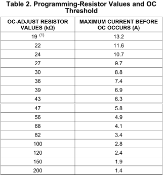

Please allow me to ask you about the over current limiting function of DRV8332. I have two questions
[Q1]
I can find the following OC programing table in the datasheet page 12. Is it possible to support the OC setting under 1.4A ?
If possible, could you provide us the formula how to calculate the OC current for resistance over 200kohm ?
[Q2]
Customer is asking for the MIN data of the OC current value.
Do you have the MIN OC current data for each resistor value ?
Thanks in advance.
