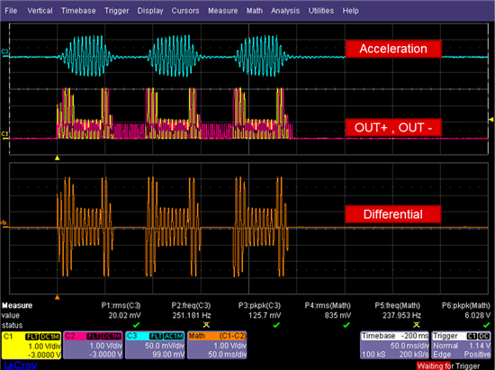

  • Yaita-san,
    The variability could be arising because the LRA is probably still moving and has not come to a complete stop. The solution to this is to increase the magnitude of braking or adding a wait till the LRA stops completely. Could you please take a capture of the acceleration waveform? (Also, what is the waveform on CH1? it does not look like Output Waveform)

  • Hi Gautham-san,
    I apologize for mistaking.
    CH1 is acceleration waveform that is captured by vibration meter VM-83(RION).
    He put smartphone on cushioning material and picked up from the surface of LCD.
    *using double-stick tape to fix the pick up and LCD(smart phone)
    My customer said he could observe the waveform variability even if LRA complete stop.
    He thinks the variability is no ploblem for his application,  however he would like to know if it derives from the device(DRV2604L).
    Yaita
  • Yaita-san,
    Attached below is an example Triple_Click from the library waveforms. The waveform provided by you has all overdrive cycles only. (no overdrive to rated transition).
    You can tune the Back-emf gain parameter(0x1A) to get more consistency and repeat on multiple LRAs. (atleast 3 units)

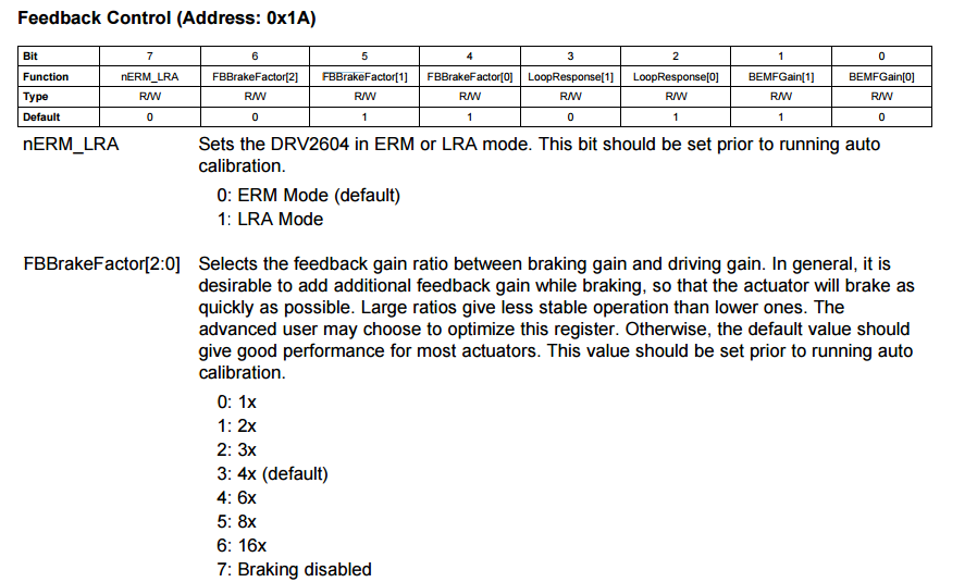

  • Hi Gautham-san,
    My customer tried to increase the value of BEMF_GAIN[1:0] and confirmed it is efficient for consistency.
    However he felt brake is weaker than before.
    Then, how do I adjust the srength of brake?
    Do I achieve it to increase overdrive voltage?
    Yaita
  • Yaita-san,
    Yes there is a way :)
    Could you recommend to try increasing the Brake Factor using the Feedback Control Register?
