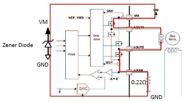

Hi Team,
My customer put Zenor Diode on VM to prevent VM rising because the phase current could be charging back the supply(VM) when the motor is running along with huge mechincal vibration.
In this case, I recognize it is possible that the current flow through following route.
Is my understanding correct?
If answer is yes, I'd like to know how much current is acceptable to flow through the parasitic diode of internal FET.
Is there any absolute maximum current value?
