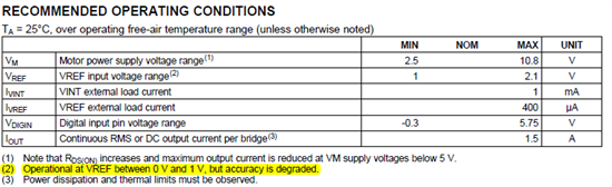

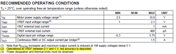

    Let me confirm the accuracy figure with designer, but I would suggest to increase the Vref above 1 volt as per data-sheet suggestion.  Current trip ccuracy is greatly sacrified below this level.

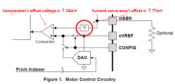

  • Kanemaru-San,
    Below is response from designer about Itrip accuracy at Vref=0.7:
    The main error comes from the offset of the internal comparator that can be as high as ~10mv.
    So when Vref is high, the error is Vref+/-10mV and this 10mv is a small %of this high Vref. If Vref is small, this 10mV becomes a higher % of Vref. This problem becomes worse when you micro-step since this 10mv error will be larger % of smaller steps. Eg. In 1/32 step  , the 1st step value is equal to Vref/20*1/5=Vref/100. If Vref is 2v, 1st step = 20mv and error of 10mv = 50% of this 1st step value. Now if Vref = 0.7v, 1st step is 0.7/100 = 7mV and this 10mV is greater than 100% of 1st step value.
    In summary: ITRIP error is = (V_stepRef +/- 10mv)/ (5*RISENSE) .

  • Hi Milan-san,
    I have one more question.
    Does the offset voltage of current sense amp (gain=5V/V) affect the full scale ITRIP error?
    So, I think that the full scale ITRIP error is the following calculating formula.
    Is my understanding correct?
    And, please let me know it if you have this value.
    <ITRIP error>
    Full scale ITRIP error is = VREF +/- 10mV / (5 +/- ??mV * RISENSE)
    Kanemaru

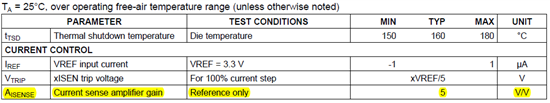

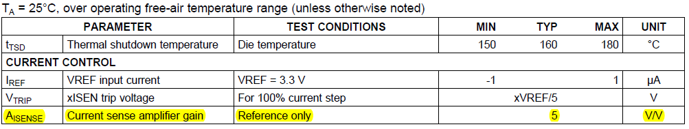

  • Kanemaru-San,
    Sorry for delayed response, I was on travel and limited access to emails.
    Yes yout undertstading is right, it also affects Itrip.
    Data-sheet specifiy minimum value of Itrip as 2A, refer to shetet6, Protection circuit row.

  • Kanemaru San,
    The Aisense (current sense amplifier gain) is ideally 5v/v. it normally varies +/-3% with temperature and across different devices. The variation is guaranteed to be within +/- 10%. Please note this 10% is a conservative 6-sigma number.
