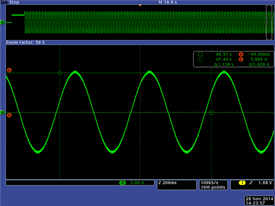

  • Hi Johannes,
    I managed to look at this issue again and this time I find another motor with smaller phase inductance which means the current noise could be bigger.
    And I just use our EVM to set the current at peak 6A.
    After test, it is true that there could be PDFx or OCP faults happens. Altough it can be improved by tuning the predriver parameters, but still a randomly rate of the fault will be reported after several minutes running. The most possible fault is BPDF.
    By further tuning, we can get that the lowside predriver current capability will be the most sensitive parameter to the fault. So we try to add four 20 to 47ohm resistors to the lowside gate only. It shows the xPDF fault could be greatly improved. Please refer to the following waveform of the 6A current running.
    The motor I used is not allow to running at 6A for long time but the effect was very obvious.
    Also I noticed that at this current level, the whole board could get very high temperature after minutes running, so if we need to run the motor at such current for long time. The PCB heat dissipation should be enhanced for long term stability.
