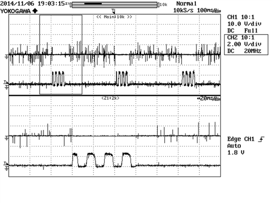

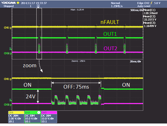

Our customer trying to check protection circuit.
1. They are forcing OUT1 to HSON and OUT2 to LSON.
2. Connecting OUT1 to OUT2 via register(Volume) to control current.
3. Rsense connected to GND, no ITrip.
At IOUT=1.4A following switching phenomena were produced by DRV8816.
Since IOCP is more than 3A, I guess it is not a OCP retry. The freq of retry is around 16ms.
Could you please let me know if other protection is exist?
CH1 is nFault, CH2 is OUT2
