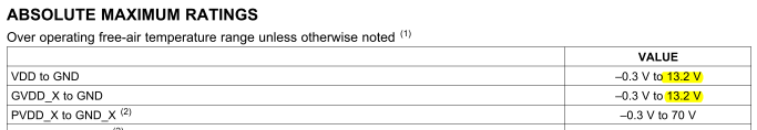

Hi Team,
I have one simple question.
Is the "Absolute Maximum Rating" of GVDD_X and VDD correct ? The maximum value were the same with "Recommended Operating Conditions".
If this is correct why does the device do not have margin from recommended range ?
Kawai
  • Hi Kawai
    I think this is true. Actually all the parameters without a recommended range, can be treat as "recommended" = "absolute". Here the recommended range is more likely to address the MIN boundary compared with the absolute rating. You can find similar example on other devices.
    So in this case, it is fully functional and no risk to operate in and must in the recommended range.
  • Hello Wilson-san,
    Thanks for the answer. I will inform customer both range are correct and to use the device in the recommended range.
    Kawai
